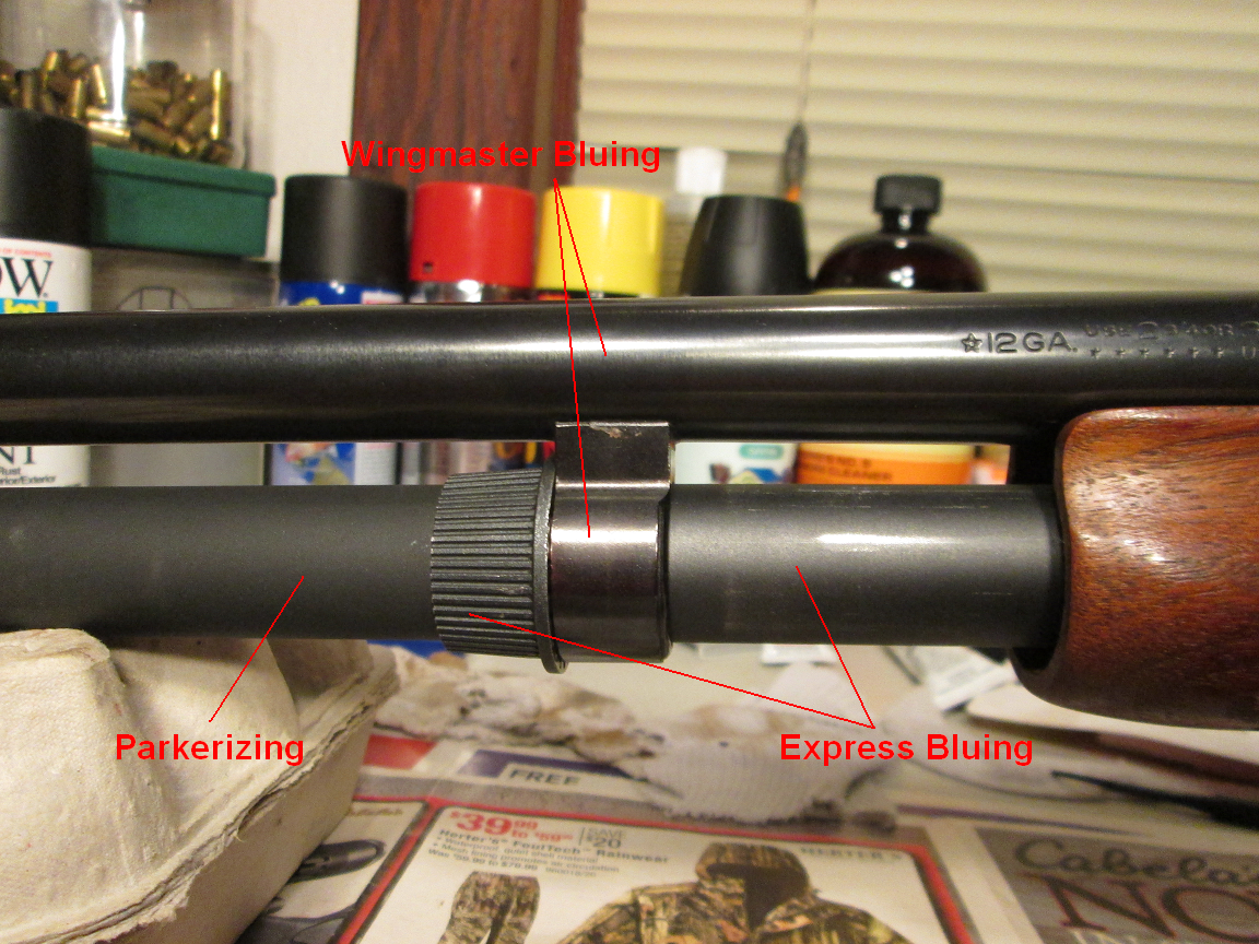

mercman wrote:The biggest difference that I see is the finish with the Express being a paint on coating.
The standard Express finish isn't a paint, it's a matte bluing. Same chemistry as the Wingmaster bluing, but a different process. It's not as durable as the Wingmaster bluing, but it works, and there are a myriad of options for refinishing the gun if you decide to upgrade. My 870 has the Express finish, and while it's worn off in some places, the only time I ever had a little rusting was after I got the thing completely soaked carrying it through hip-deep mountain snow, then let it sit for many hours after I got home before taking it down and caring for it properly. I won't blame the gun for that one.
Here's my 870 Express with a Parkerized +3 extension and my 20" Wingmaster barrel.
870 finishes.PNG (2.37 MiB) Viewed 11946 times

Thanks Synchronizor for the good info. The picture and explanation of the different surface treatments was enlightening. I'm beginning to think Express might be just as viable as the Wingmaster for my needs.
