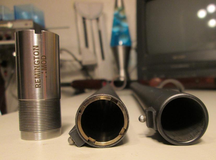

ChadATL wrote:Now my question. Did these guns come with a choke or threaded for a choke? I cleaned it today and looking down the barrel I can see a different type of metal at the sight end. I guess that would be a choke.
From right to left in this picture: 12ga 870 barrel with a fixed choke (Cylinder); 12ga 870 barrel threaded for interchangeable chokes with a flush-mount tube installed (Full); 12ga RemChoke flush-mount choke tube (Modified).
ChadATL wrote:I'm wondering if this limits what type of rounds I can use in it. I'd like to know if it's safe for any type or shot and slugs.
You'll have to pull the choke tube out and read the markings on it to see what constriction it is. Generally speaking, lead slugs and any type of shot can be fired through Modified or lighter constrictions without issues. If you're buying slugs though, be sure to read the manufacturer's recommendations on the box to be sure.
ChadATL wrote:Any info would be great, I can try and post pictures if needed. I do not have any type of tool to take the choke out. I guess there is a specific tool for that.
If the previous owner took care of it properly, the tube should thread out without much effort; you ought to be able to either stick your finger into the tube and screw it out, or use a coin in the notches to break it loose. Choke tube wrenches are only really necessary for neglected tubes.

Ok, the choke came right out and is the same modified one you have in the photo. Can you tell me what this choke is used for? Can I harm the barrrel if I shoot without a choke in it? I would think you'd get lead in the threads.

ChadATL wrote:Ok, the choke came right out and is the same modified one you have in the photo. Can you tell me what this choke is used for?
Modified chokes are usually designed to try to get about 60% of a pellet payload in a 30" circle at 40 yards (the %/30"/40 yards system is kind of odd, and not all that great on its own for determining anything useful, but it's more-or-less the standard for chokes; welcome to the confusing and archaic world of shotguns).
More practically, Modified chokes are useful for certain hunting roles and some folks like them for quick shots in trap shooting, though I see more people running Full chokes for trap. It's also a constriction used in some police and military shotgun barrels to improve the effective range a tad over Cylinder or Improved Cylinder (buckshot response to choking tends to vary quite a bit from load to load, though).
ChadATL wrote:Can I harm the barrrel if I shoot without a choke in it? I would think you'd get lead in the threads.
Never fire the gun without a choke installed. It won't just get the threads dirty, it'll damage them.
