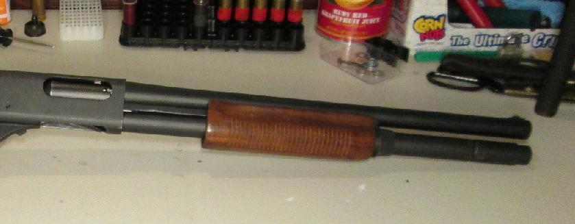

I have the original vent ribbed express barrel on mine still which I believe was around 25" before I chopped to 18.25". I reinstalled the bead sight and that's all I have done so far. I do use it on my property of about 3 acres for small stuff. I get rabbit no problem, but rabbits are pretty stupid on my property for some reason LOL, have gotten a turkey or two as well as they tend to get pretty close to my house. However if I plan on doing any long range shots then that 18.25" barrel is worthless. LOL I would do your research and ask around too. Not to mention that guy Synchronizor really knows what the heck he is talking about so take heed to his advice. Maybe look around online, say ebay for some used barrels this way you are not spending too much money in case it is not what you are looking for. I personally like the tactical barrel from remington as it is 18.5" and has the Rem-choke option This way if you want to keep it short you can pop in a different choke for different occasions. With the right choke you can roll some varmint from a good distance on a short barrel. Good luck.
