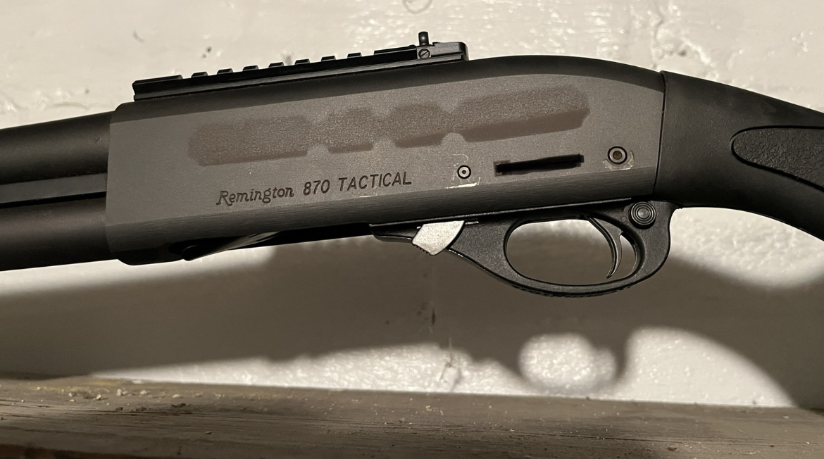

I had a Mesa Tactical SureShell Aluminum Carrier on my 870 tactical for a few years. Got tired of it and when I took it off the receiver is stained a slightly reddish color where the rubber pad sat between the carrier and the receiver.
Does anyone out there know of the best solvent to use to remove the stain? There is no sticky residue. I did not use the optional adhesive when I mounted it.
I’ll try to post a pic. I tried searching already and couldn’t find anything like this.
Thanks

Hmmmmm. I would try a hairdryer set on medium first and try to volatize-off whatever that is before I'd slap solvents on it. Then perhaps some Hoppe's No.9 and a soft toothbrush. Let us know.

I had the exact same thing happen to me.
I believe it is rust as the rubber pad may have trapped moisture. I tried kroil and bronze wool but that did not help. I ended up getting the gun reparkerized. I also ditched the Mesa side saddle. That rubber pad is there to prevent scratches. It seems to leave a far worse problem if you are not keeping up on oiling the gun.

Oban14 wrote: Thu May 12, 2022 8:10 pm I ended up getting the gun reparkerized. I also ditched the Mesa side saddle.
That’s what I thought. Thanks. Wish I could get Mesa to pay for it though. 👍
