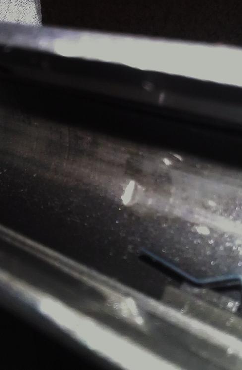

I just have one more quick question... again... new to the 870. Never seen this before. But after putting rounds through it I decided to give it a quick cleaning and noticed something. WTF is this????
It is a notch something on the top inside of receiver. Basically if you disassemble the gun and look through the bottom it is right up top. I am sure it is nothing but just wondering what it is for and why it is there.

rythomas0704 wrote:I just have one more quick question... again... new to the 870. Never seen this before. But after putting rounds through it I decided to give it a quick cleaning and noticed something. WTF is this????
That notch is caused by the locking block when you rack the slide back. That part locks into a notch in the barrel when the action is closed, and tends to drag along the roof of the receiver as the bolt moves back and forth. You can see the track where it's been worn down. When the slide assembly reaches the back of the receiver, it stops suddenly when it hits the protruding bottom of the receiver stud, but the breech bolt assembly that rides on top of it still has a fraction of an inch of rearward travel before it stops moving as well. As the bolt slides backward over the slide assembly, the locking block cams up and taps the roof of the receiver. Over time, those impacts dent the receiver slightly.
You can see why 870 owners are fond of the gun's milled steel receiver. That material choice lets it withstand the cumulative wear caused by this kind of part interaction over thousands, tens of thousands, or even hundreds of thousands of cycles.

Thanks Synch. Appreciate the info. I thought it looked like wear and tear but was not sure. The gun is in such good shape that I couldn't think that was the case. I guess I was wrong.
