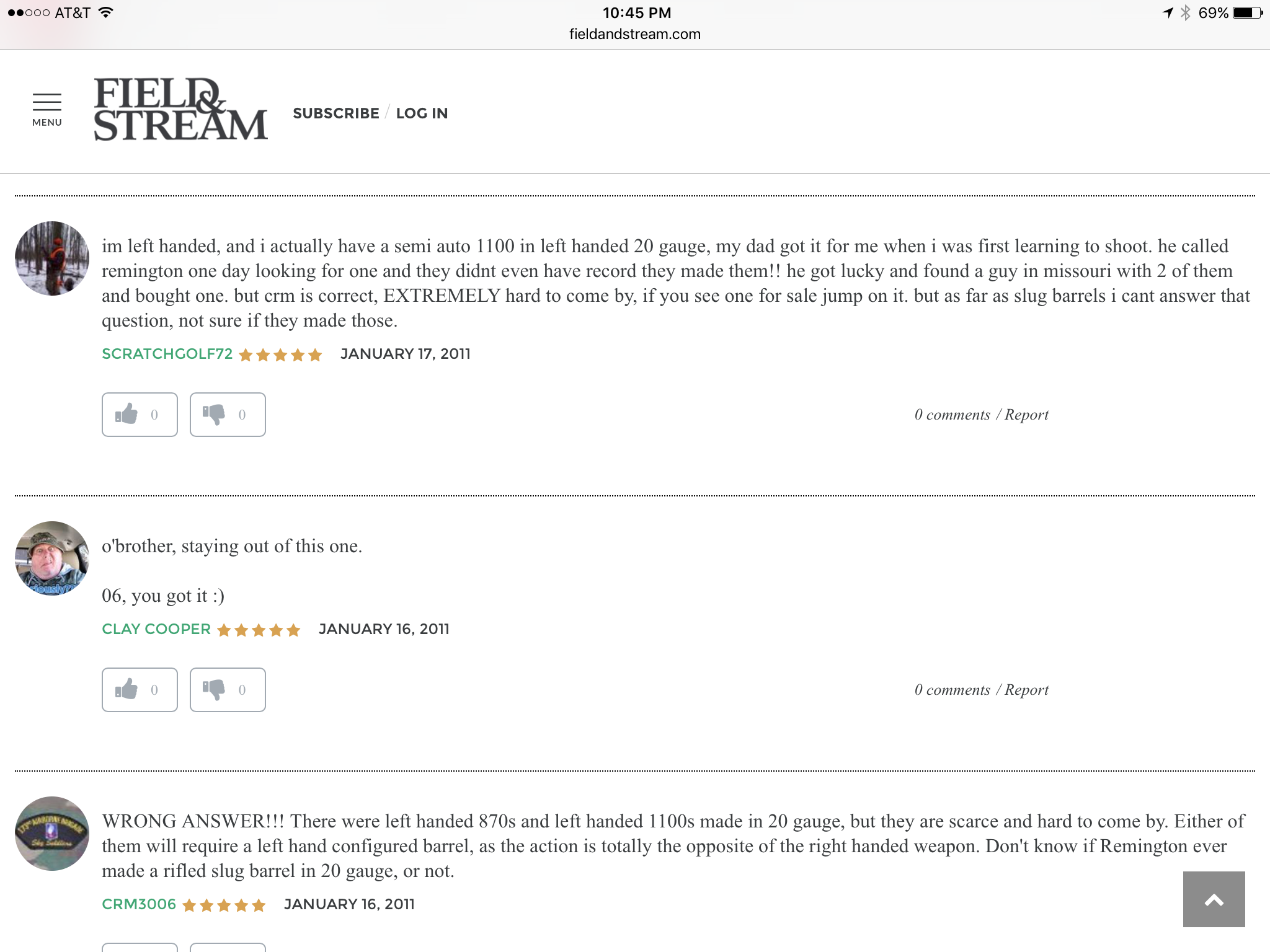

I believe Remington made 20ga LH models in the past, but currently it's just 12-gauges. Never heard of left-handed 870s chambered for the other three bore sizes, or left-handed SuperMags.

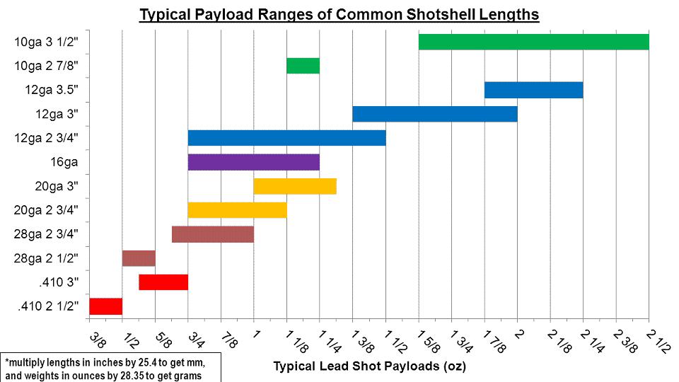

The 16 is a fine gauge, no doubt about it. It can hold enough shot and handle shot sizes large enough for a wide variety of game, as well as various shooting games and even combat/defense. Its range of 3/4-ounce to 1 1/4-ounce is just about ideal for the vast majority of what shotguns are used for, and guns built around its bore diameter and weighted properly for its payload weight range can make for wonderful guns that are noticeably lighter and trimmer than those designed for the larger 12ga bore, and its potentially much heavier magnum payloads.
Unfortunately, if the gun is not built to take advantage of that, the 16ga is pretty pointless, as the 12ga can do everything the 16 can just as well (if not better), while being more versatile, capable, and common. That's what happened with the 16ga 870s, which is why I see little point to them aside from some collector value.
