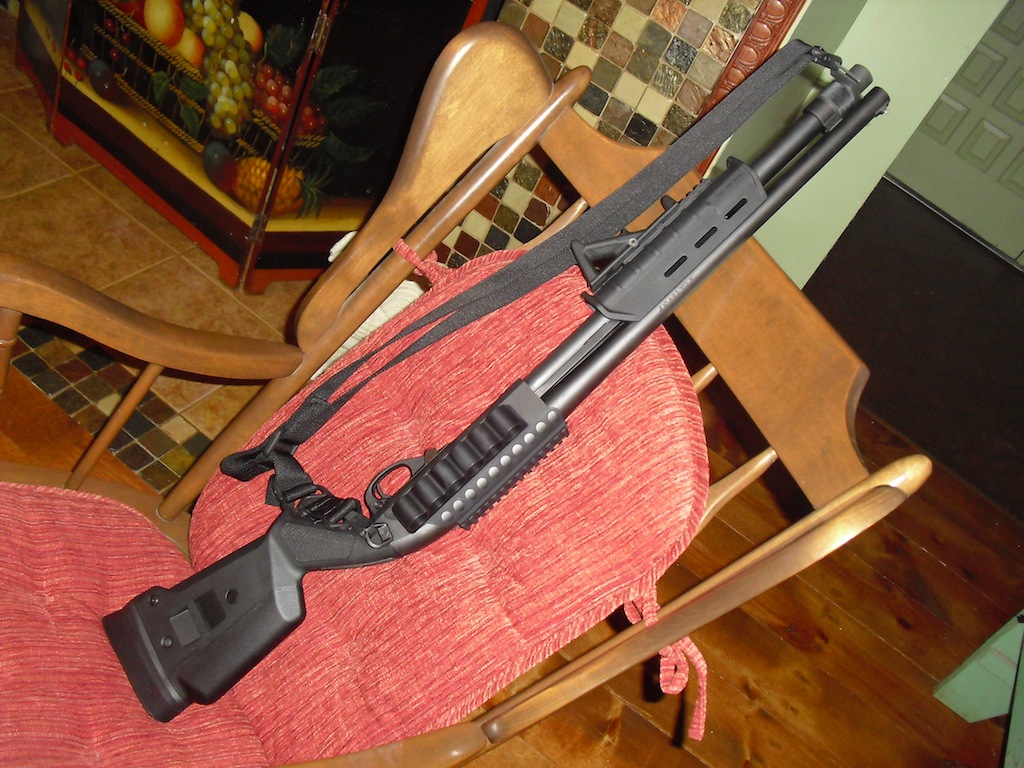

12-GA Express Synthetic 7-Round (25077)
Mods:
non-MIM Extractor | SS Follower | Heavy Magazine/Sear/Carrier Latch Springs | Jumbo Head Safety | MOE Forend/SGA Stock w/ Rec Sling Mount | Mesa Tactical 6-Shell Saddle
If you're just after that breacher choke, you could have your current barrel threaded for choke tubes. Or, Remington makes a long-mag, bead sight, Rem Choke barrel for their #81193 Express Pistol Grip model. I don't know the part number or price for that barrel off the top of my head, but you should be able to track it down if you call Remington.
