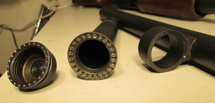

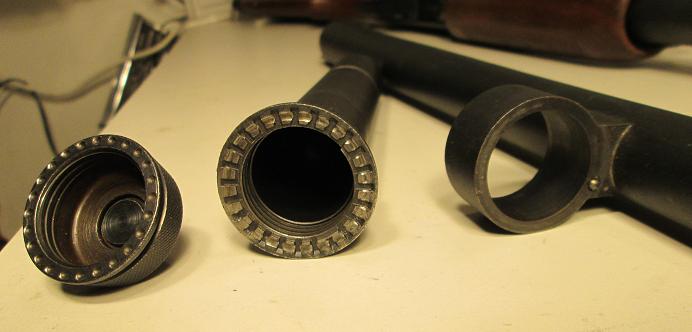

The barrels on Police 870s and some civilian models have a ball detent in the barrel guide ring. These ball detents are used to lock down magazine caps or extensions.
- Ball detent
- 870 barrel guide ring ball detent_small.JPG (35.34 KiB) Viewed 5817 times

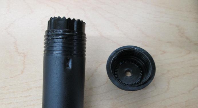

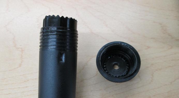

Around 1993, Remington started using a new-style plastic spring retainer on models without tube extensions. These new retainers engaged two bumps in the end of the mag tube, and provided a ratchet system to lock down the magazine cap.
- Synthetic retainer ratchet
- 870 ratchet retainer_small.JPG (32.01 KiB) Viewed 5817 times

These were a cost-saving measure, and work well enough for guns without extensions. They're also less of a pain to take out than the older-style, press-in spring retainers. However, the bumps in the magazine tube that these new retainers need to lock in to to work will interfere with the follower if a magazine extension is installed, so they have to be pressed out, filed off, or drilled out.
Barrels for shotguns with this new system do not have ball detents in their guide rings, but it can be added. You can also use a wave-style lockwasher to keep a cap or extension tight.

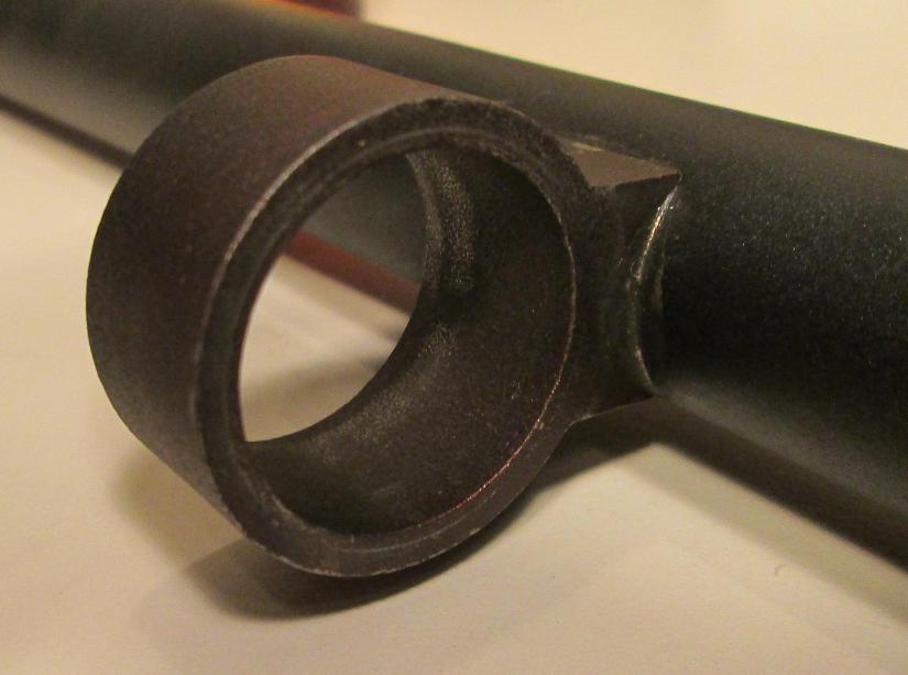

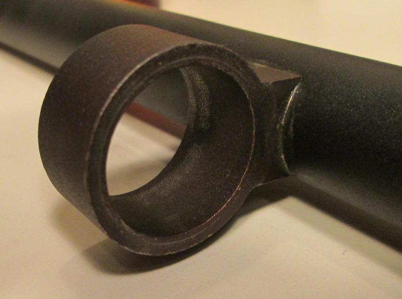

- Guide ring without ball detent
- barrel guide ring no ball_small.JPG (51.06 KiB) Viewed 5817 times
You can put any 870 barrel on any 870 receiver, as long as the gauge and mag tube length match up; but if the barrel doesn't have the ball detent in the guide ring, unclamped extensions and some styles of magazine caps may work loose during extended shooting sessions.
