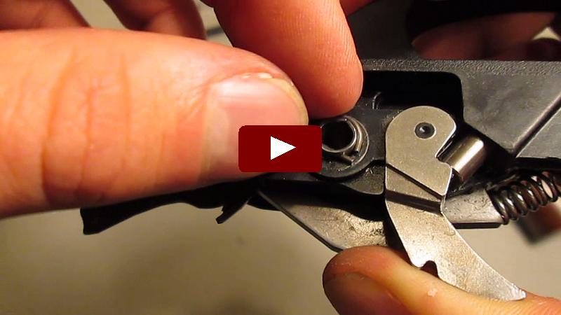

The Remington 870’s trigger plate assembly is attached to the receiver by means of two trigger plate pins. Holding these pins in place are two clips called trigger plate pin detent springs.
In this video, I go over three easy things you can do with these detent springs: moving the front spring over to the same side as the rear spring for simplified takedown & assembly, adding a second front detent spring for more secure pin retention, and removing all detent springs to simplify installation of receiver-mount accessories.
