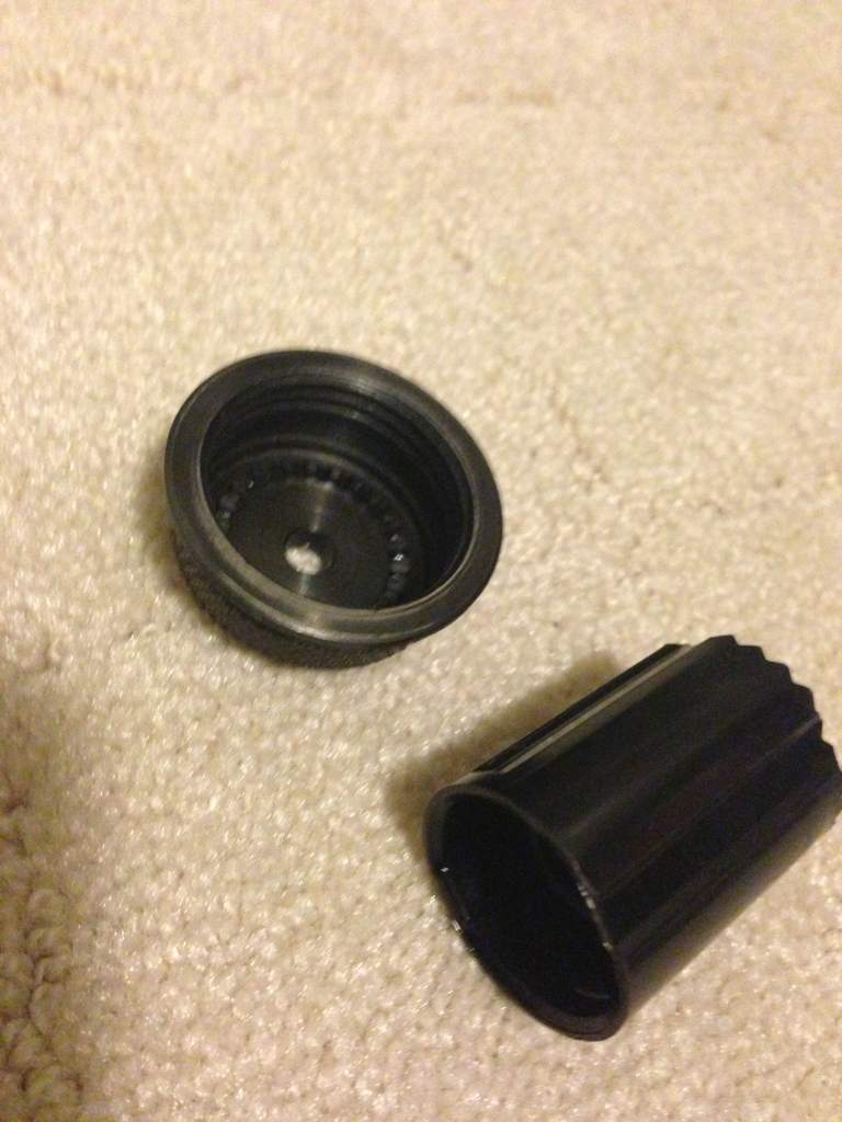

Bloodstriker
Posts: 8
Joined: Tue Jun 11, 2013 1:19 am
870 Retainer - Do I need to use it?
Post by Bloodstriker »
Okay, so there's no ball detent. Here's a pic.
ImageUploadedByTapatalk 21370926976.310209.jpg (71.49 KiB) Viewed 10370 times
What I did was simply drop the retainer in and then screwed the cap on. I played around with the follow and the resistance seems about right.
I guess I am good to go?

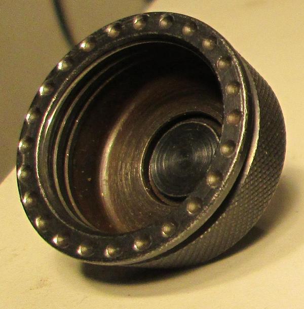

My 870 came from the factory with an extension installed, and so doesn't have dimples in the magazine tube. For builds without an extension, I just use an old magazine follower to ensure that the end of the spring doesn't hang up on the inside of the cap. You can see a video of the setup here.
I've run the gun with nothing between the cap and spring, without ever having a problem, but I use an Uncle Mike's cap with a smooth inside end:
UM 870 cap inner.JPG (51.21 KiB) Viewed 10343 times
In your case, since your cap has the teeth inside, you probably want to have something between them and the spring to avoid snagging the spring as you tighten the cap. A factory follower like I use would be best, but if you don't have a spare one of those lying around, just use your old retainer instead. Stick it on the end of the spring, push it into the tube with the cap, then tighten it down as hard as you can by hand. It won't work as well to keep the cap tight without the dimples to lock into, but it'll still hold the end of the spring. Just tighten the magazine cap down good and snug, and check it between rounds to make sure it's still tight.
