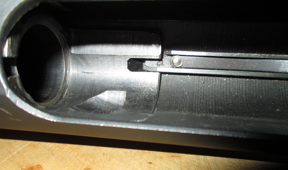

Post by MStarmer »
I've noticed this in several pictures of 870's. Is this common? When I'm cleaning mine I keep looking at thinking that it needs to be "fine tuned" and flushed up with the edge of the ejection port. Excuse the poor cell phone pic but I think you get the idea.
Suggestions? Dress it back, leave it alone?

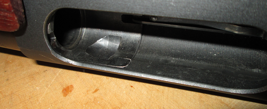

That doesn't look normal to me. I doubt it'll affect function, the 870 doesn't rely on ultra-precise part fit, but it is kind of unsightly.
Can you post a close-up of the barrel extension with the bolt open? Here are some shots with one of my barrels for comparison:

Post by MStarmer »
Wow, yours are a significantly better fit. I took 2 more pics. At first I though maybe it got dropped and bent the corner of the extension but looking at it apart it obviously is too thick for that, it just appears to maybe be "tolerance stacking"? Looks like I could take it down flush without any issues?
Re: Barrel extension overhang into ejection port.
I'd check to make sure there isn't a gap between the receiver and the top of the barrel extension. It'd also be smart to have a professional look at it in person before you start cutting on it. That's not something you want to do lightly.
