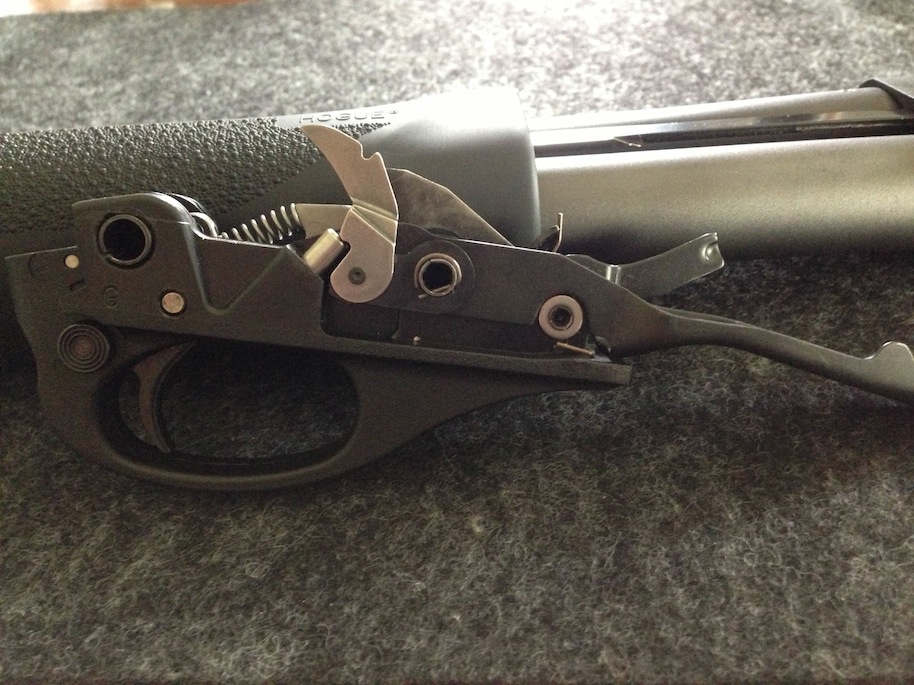

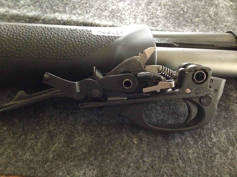

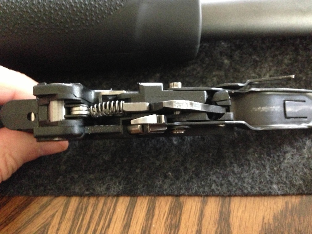

OK. Attached are some pics of the trigger assy. I also attached links to some short video clips I took that may lend some clues to my issues here.

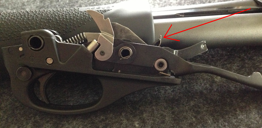

They say a picture's worth a thousand words. I think I see your problem right there:
The end of your action bar lock spring is sticking up, while it should be held under the top arm of your action bar lock. If I was a betting man, I'd bet money that that spring is what's snagging your action when you rack the gun.

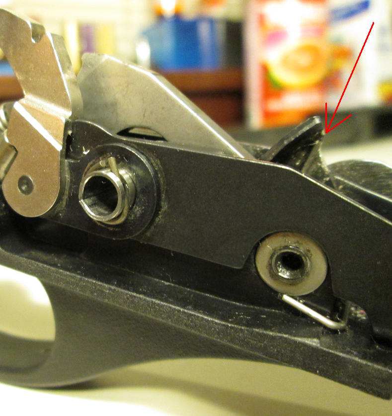

This is the part I was referring to:
The action bar lock spring on my 870 fits under the action bar lock, instead of sticking up:

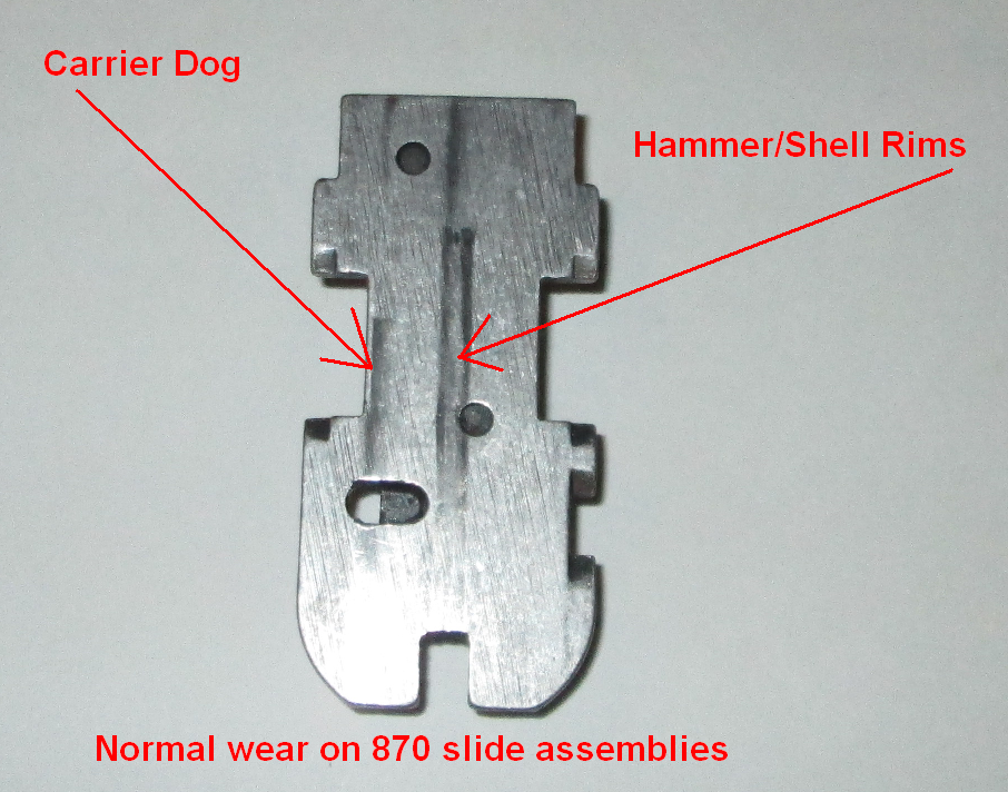

However, looking through other pictures online, it seems that many 870 trigger plate assemblies have that spring sticking up like yours, so maybe that isn't your problem after all. If you look at the bottom of your slide assembly, is it scratched on the left side in such a way as to indicate interference? While you're looking at that, see if you can find any other abnormal wear marks that might offer clues.

Your slide assy looks about like mine.
I have noticed the top of the breech bolt assy has wear marks I never noticed before.
