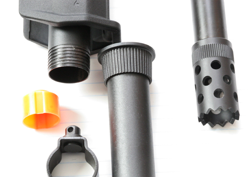

Synchronizor, thank you so much for a fast reply. I haven't figured out how to upload photos yet but I did photograph the threads after removing the 2 round extension and there are no dimples below the threads. If I understand you correctly, if I am able to drop in the new follower without the need for grooves to pass any dimples - it should work. There should be no issues when the follower reaches the other end where it mates with the receiver - all 870's are the same at that end of the magazine tubes and the stops therein?
Again, thank you. Steve

Just in case anybody is wondering. I finally got around to ordering one and it dropped right in and ran like a champ. Steve
