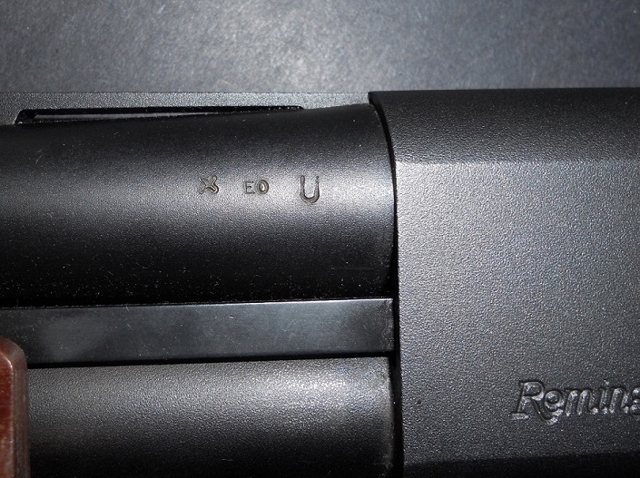

Hello,
I have a question regarding the date of manufacture & serial number of my Remington 870. Just want to be certain I understand the information provided on this website.
The date code on my 870 is "EO" as shown in the attached image. So.....the gun was made in October of 1994 (or perhaps 1977).
What are the other marks on either side of the "EO"?
Other references I read mention letters as part of the serial number. My serial # is B211976M. Does the "B" and "M" have any meaning?
Thanks,
Dan

Expresses weren't introduced until the 1980s. I'm not sure about the other marks, but they may be proofing or testing stamps.LtDan wrote:The date code on my 870 is "EO" as shown in the attached image. So.....the gun was made in October of 1994 (or perhaps 1977).
Not sure about the "B", but the "M" at the end means your gun has a 12ga Magnum receiver, capable of cycling 12ga 2.75" and 3" shells (as long as the barrel has a 3" or longer chamber).LtDan wrote:Other references I read mention letters as part of the serial number. My serial # is B211976M. Does the "B" and "M" have any meaning?
