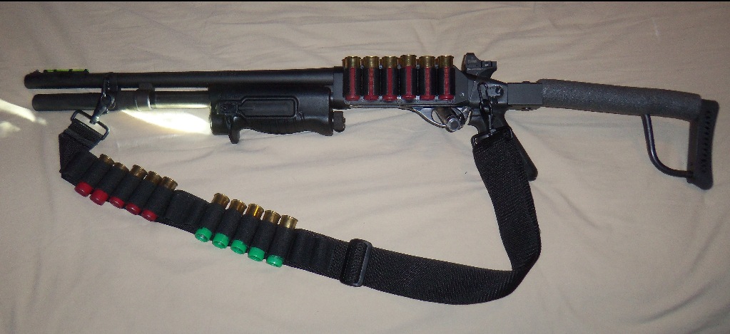

TI finally put the finishing work on my custom 870 home defense gun yesterday when the last of the parts arrived. I did this in 4 phases over 1 year.
Phase 1 was to disassemble the 870 and turn the receiver over to my gunsmith for bead blasting and DuraCoating in HR matt black. Both sides of the receiver were rusted through the original bluing and I wanted all that removed and a good quality coating applied.
Phase 2 was to inspect all parts for quality and function, then reassemble the gun to check for operation. Then I installed a Remington 18 inch smooth bore "Police barrel," a Butler Creek folding stock w/pistol grip, and a Choate Plus 2 magazine extension.
Phase 3 I installed a Tac Star 6-round ammo saddle, EOTech 120 lumen LED forend, and a Blackhawk sling with 15 shotshell loops. At that time I wrapped the 2 top steel rods of the Butler Creek stock with foam, water-pipe insulation to reduce recoil damage to my face!
Phase 4 I installed a Burris Speedbead red dot rear sight and a Hi Vis snap on fiber optic front sight.
The build is over and now comes testing with different rounds to get the red dot sight adjusted. I will be using 3 basic rounds. Federal 2 3/4 inch 1 ounce lead hollow point rifled slugs, 2 3/4 inch Federal 00 buckshot, and Federal 2 3/4 inch #1 buckshot. I do have a box of Seller & Bellot rubber buckshot but only for running off the black bears that destroy my deer feeders.
One note, this 870AP Wingmaster was originally manufactured in June 1950 and was 62 years old when I started this project. I must say that it looks nothing like it did when manufactured 63 year ago! I have all the parts that I removed from the gun and can put it back into its 1950 configuration anytime I want. I specifically researched all options installed so there was no grinding, drilling, or tapping required. And there is something to be said about Remington's manufacturing specifications remaining unchanged over the decades as I could order an aftermarket part made in 2012 and it installed without having to modify either the gun or part. Great work Remington!
Here's what she looks like.
Finished My 870 Custom Defense Build

Re: Finished My 870 Custom Defense Build
Thats cool
Wow! Looks great! Very interesting setup!
Nice setup. Very cool to see a vintage 870 that's just as serviceable as guns 60 years younger.
Do you always have that sling on, or do you keep it handy, ready to snap on if you're heading outside? I specifically avoid slings on my bedside builds, because I can't see them being good for anything besides hanging up on every piece of furniture inside the home.
I put that sling on for the photo so I could show all the accessories I acquired for the gun build. I keep the gun leaning up next to my bed at night and the sling is not on it. I also have a Hunter brand leather belt that holds 18 shot shells. I put the sling back on and also wear the ammo belt when I'm out walking in the woods.
