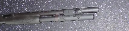

I found a Choate +2 and with hesitation I ordered it until Nordic Components gets more out to distributors. After getting it and installing today I am VERY pleased. It is actually very good quality and the fit and finish are excellent. The Choate has a follower, spring, extension (of course) and clamp/sling mount. I did NOT use the follower that was supplied as it seemed to be a little tight. I just used my original one until I get am upgraded one. Also, I modified my clamp to accept a small picatinny rail which made it a super low-profile light mount. ;) My barrel is roughly 18.25" and the extension stops about half inch behind the muzzle. Should fit an 18" perfect.

I am desparetely looking for a Remington brand +2 extension. I bought a Choate +2 for the time being. Actually the Choate is a very high quality mag ext., and pretty nice. I have a Rem 870 Super Mag w/18 1/2 barrel and the Choate +2 ends just behind the barrel.
