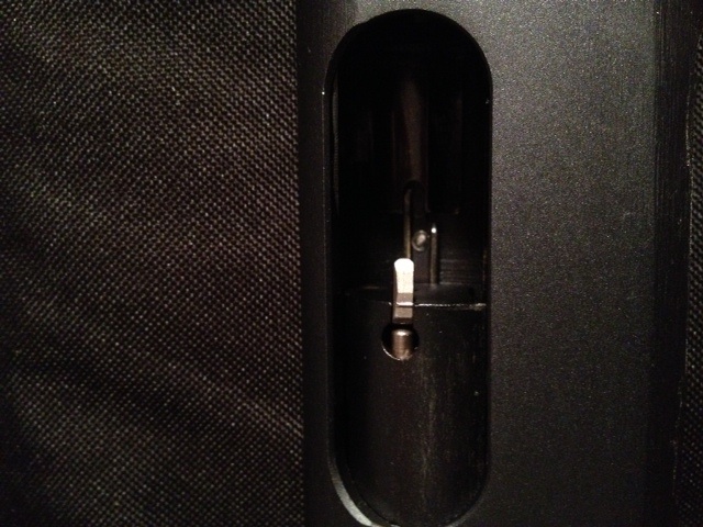

GT99BLACK wrote:The shell comes out of the magazine and gets caught up on the carrier as it moves the shell to the chamber pretty much halfway to the chamber.
Yeah, I'd like to see images of that too. What it sounds like you're describing is a fail-to-feed issue these shotguns can have when trying to chamber shells that are longer or shorter than SAAMI specs, but if the problem goes away with the original parts, you must be talking about something else.
GT99BLACK wrote:It felt like there was friction from the extractor.
I've heard of people getting the wrong extractor when buying from 3rd-party vendors, such as 11-87 extractors being sold as 870 extractors. If you have the wring extractor, it may not fit the bolt quite right, affecting function. This is one reason I always buy Remington parts (especially small parts) directly from Remington. I know I'm getting the right part, and it usually costs less as well.

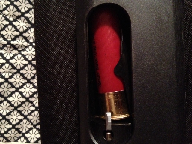

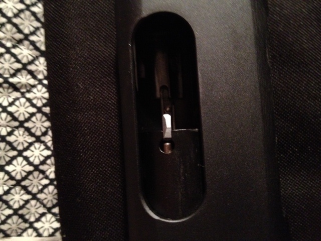

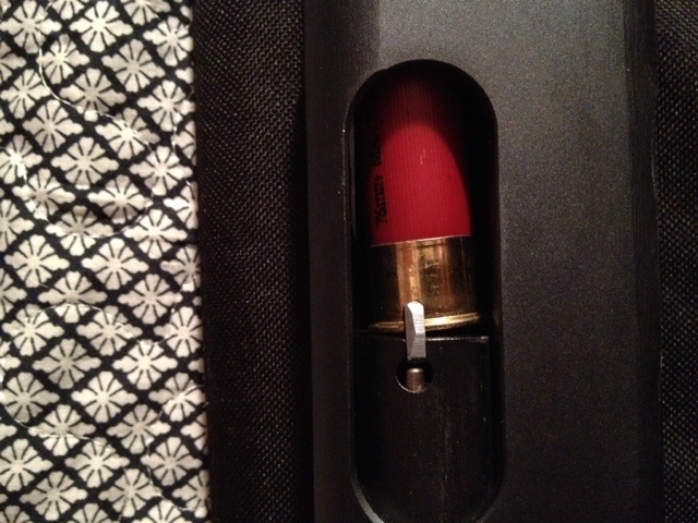

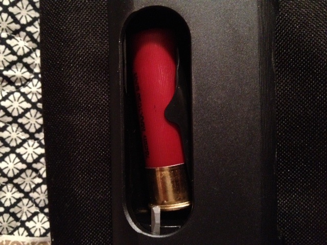

Took some pics. This is the non mim extractor and shell getting stuck. I can only upload 3 pics at a time since im not using image hosting.

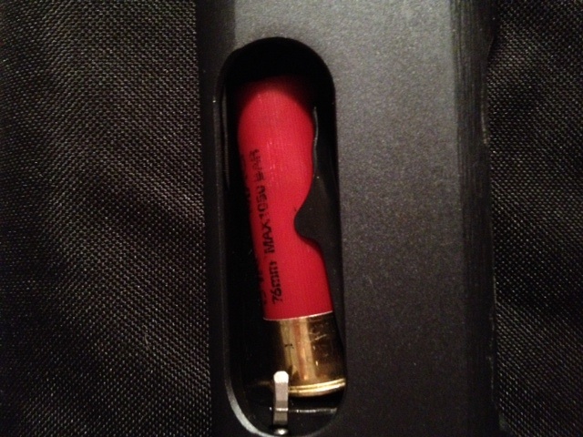

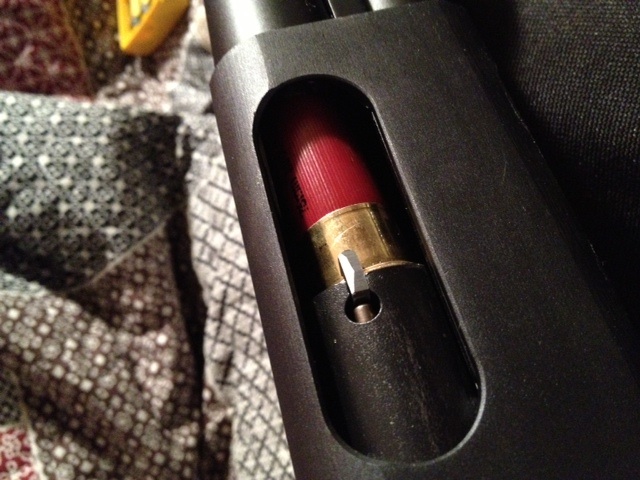

More of non mim + stuck shell

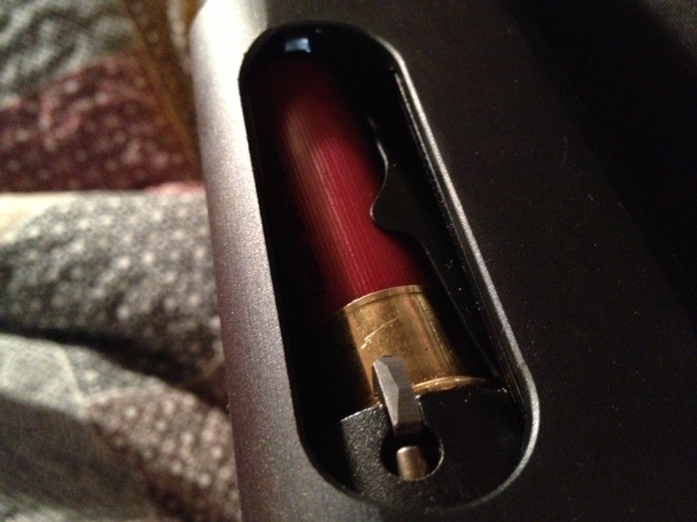

Original (top) vs non mim

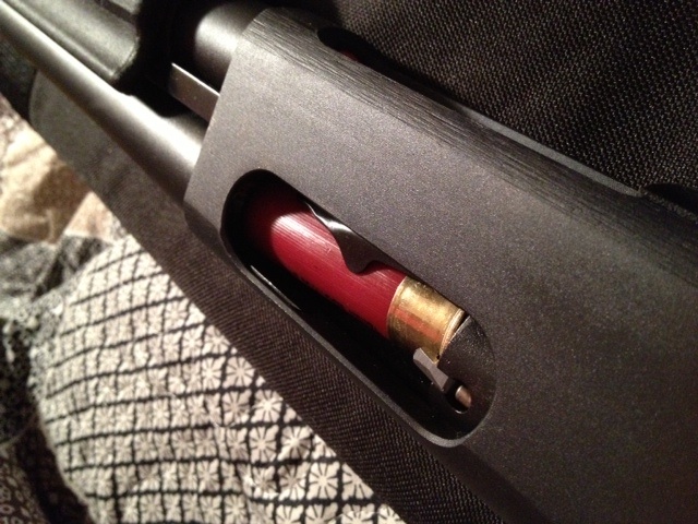

Good feed with original extractor below
