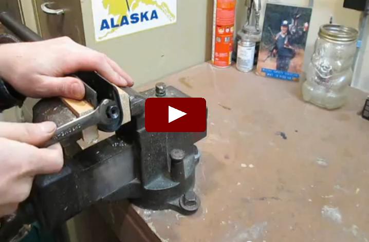

Remington 870 Tips & Tricks #2: Receiver Stud Replacement & Repair:
This Remington 870 Express Synthetic had its stock bolt forcibly screwed all the way in while cross-threaded, which damaged the threads on the stock bolt, as well as the threads receiving it. In this video, I’ll demonstrate how to replace the receiver stud, and also show how to repair the stud’s internal threads if they are not too extensively damaged.
