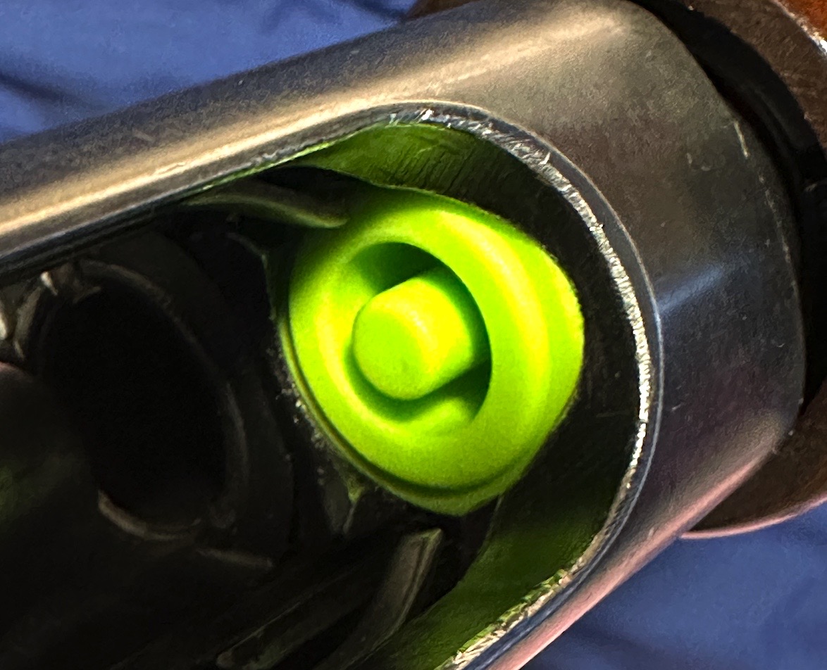

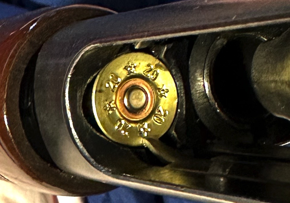

So I took some pics of my 20ga's magazine.
870 20GA Follower.jpg (228.35 KiB) Viewed 12000 times
870 20GA load.jpg (148.92 KiB) Viewed 12000 times
Compare these as to what your's looks like. It might help if you can upload pics of yours.

Hi again, BKinzy, and, again, many thanks for your efforts. I managed to fix the problem, and I will try to explain below how I did it.
Looking at your excellent close up picture of your shotgun's follower, you can see that the edge of the follower rests against a tiny rim at the end of the magazine tube which stops the follower from going past it and interfering with the shell stops. The ledge is called the "magazine follower stop." As you know, the magazine tube on the 20 gauge RemingtonMAGNUM is larger, 12 gauge instead of 20 gauge, so the ledge is wider. My reading indicates that tiny burrs can build up on the edge of this ledge, and when the rim of the shell hits the stop, these burrs capture the rim of the fresh shell and prevent it moving to the center where it can feed. I believe that this wider ledge causes the problem, and I gather that this problem is much more likely with the 20 gauge guns on 12 gauge frames.
Fixing burrs ought to be simple enough, just polish them out. Problem is that the burrs are at the rear of the magazine tube and mostly inaccessible. Then I measured things and discovered that the inside of the 12 gauge magazine tube is a bit over .901 inch. Eventually it dawned on my slow wit that the inside of the magazine tube is just slightly larger than 7/8 inches, so I got a 7/8" dowel, screwed a little Dremel Too sanding disc to the end of the dowel, slipped it inside the magazine and twirled it to smooth off the burrs. After three weeks of serious thought and help from people like you, the problem was fixed in about five minutes.
