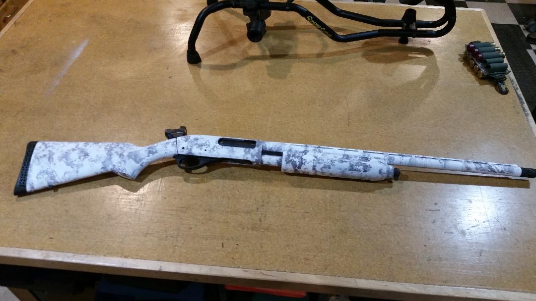

If you're planning on stripping the whole gun you can sand blast it with some fine sand. I've done it a few times. You can recoat with Duracoat and an air brush if you plan on doing a hydro dip which really isn't that hard or the air dry ceracoat that doesn't have to go in an oven to cure but that is a lot more tricky to hydro dip.
The hardest part is putting your gun in a sand blaster.
I disassemble mine and I don't do the trigger group, but you could. Just doing the stocks shouldn't be that big a deal. Blast it, clean it and spray it.
I'd stay away from spray paint, I've been down that road a couple times and it just doesn't last.
The Duracoat has lasted very well on mine, I went with white and did a snow camo hydro dip with matte ceracoat clear over the top and it's amazing how well it holds up.
I did my 10ga BPS with tan ceracoat and it was a fight to hydro dip. If the ceracoat is cured the hydro dip doesn't stick well. You have to dip it when it's ok to touch but before it cures so it will stick. Took me a couple tries but I finally got it and did a matte creacoat clear over the top.
