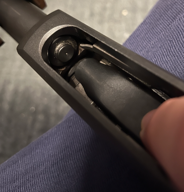

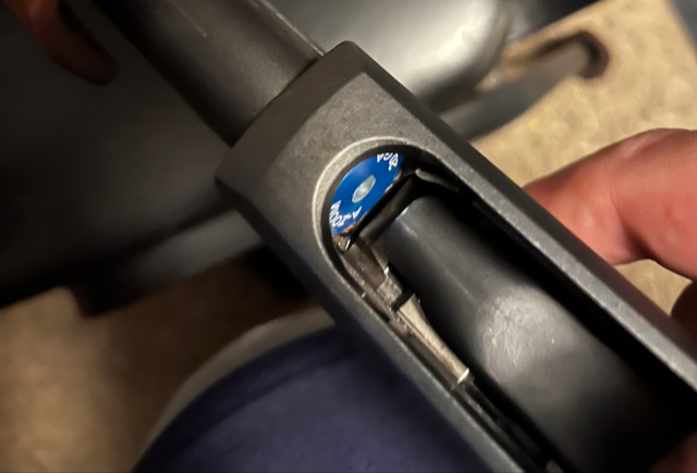

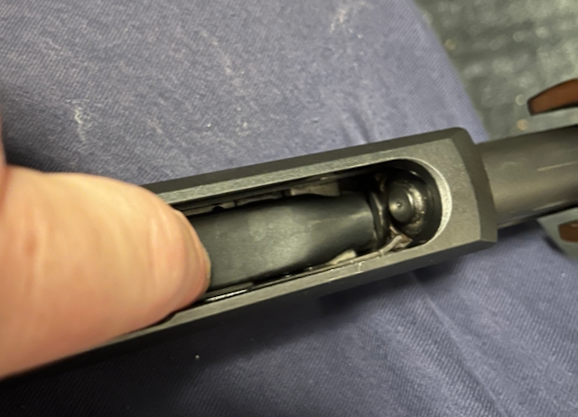

This 870 Magnum Express was purchased as a gift for my mother by my ex-stepfather. He supposedly bought it at a gun show in the mid-90's. She has never shot it, and recently gave it to me. I gave it a light cleaning. Barrel had a fair amount of stuff in it.
I cycled one snap cap through it no problem. When I tried cycling multiple any that were pushed fully into the magazine would not come back out unless I disassemble the magazine and slide them out the front of the magazine. (Remove the cap, remove the push retainer, remove the spring and follower. Then they will slide out, but some the rim is stuck right at the opening of the magazine. I thought maybe the new snap caps were incorrectly sized, but tried in the backyard with live rounds - two different brands. Same thing.

To follow up.
The rim of the shells is catching on the edge of the magazine tube. As I looked at it with an endoscope I see some raised solder marks. If I load one shell and do not push the rim into the magazine tube it cycles fine. If I push a shell into the magazine tube, any shell that goes into the magazine tube won't come back out without removing the cap.

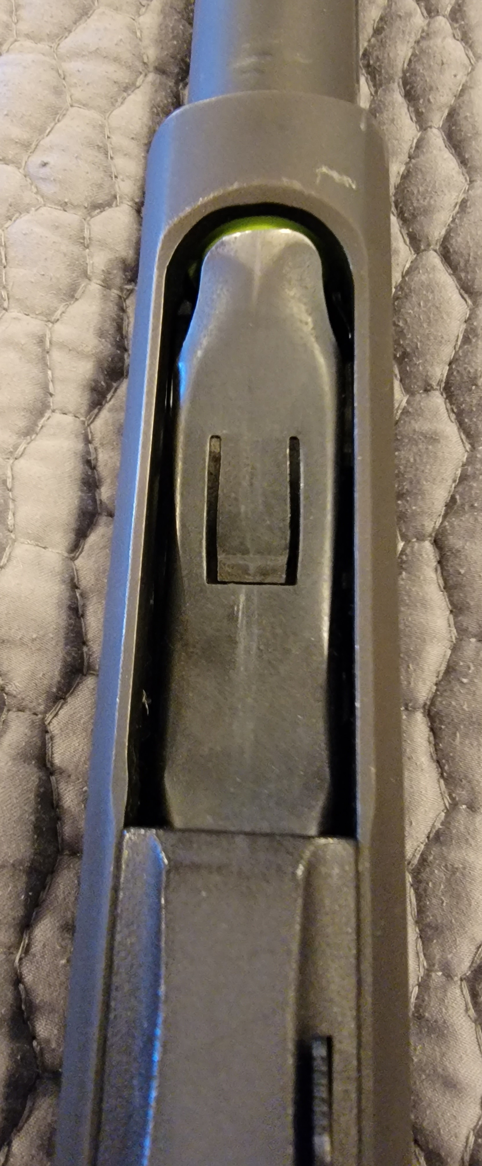

Re: Remington 870 20-gauge likes to get rounds stuck
Notice the notch cut in to mine. I'd read that this was a FTF remediation that Remington came out with. Could this be the problem?
- 20211229_131032.jpg (1.22 MiB) Viewed 4635 times
That squared-off U-shaped cut? That is a formal mod called the "flex tab" IIRC done by Remington to fix shells binding in the receiver.
That's the cut. I'd read that it was to keep shells from binding, but I thought I'd post just in case. Thanks Shipmate!
