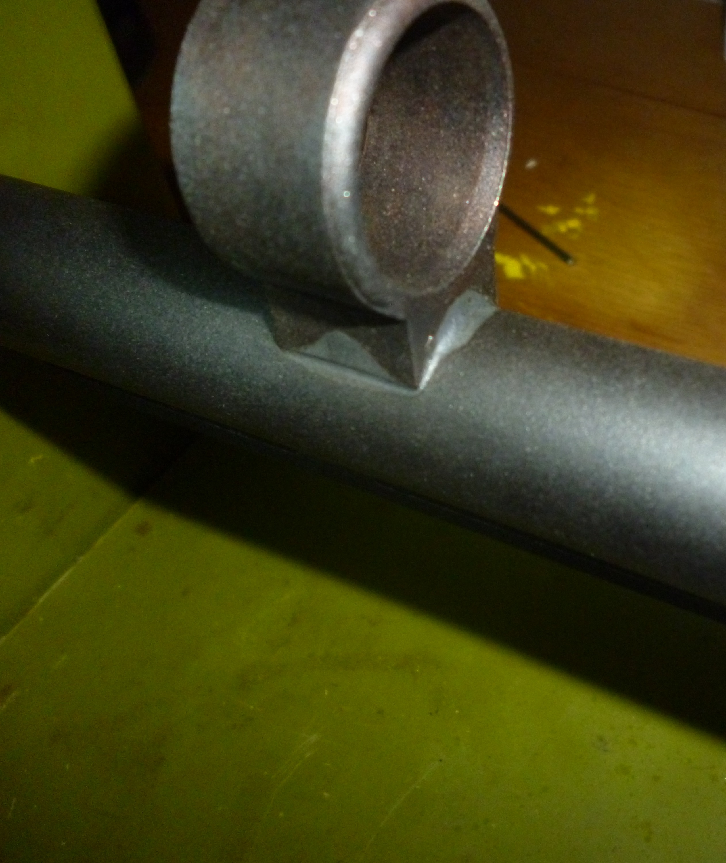

Hi guys! I just got this Remington 870 non rifled barrel. I noticed theese miscolored areas on the base of the barrel "ring" ( dunno what the ring is called ). Have any of you seen something like this before, or know what it is?

It is Silver soldier holding the barrel support ring in place. if it bothers you Brownells used to sell and still may have a chemical that will blacken it somewhat. A black sharpie is a temporary fix, but the black ink will wear off over time and with cleanings. No big deal really, most people just live with it.

Banshee wrote: Thu Sep 02, 2021 8:56 pm It is Silver soldier holding the barrel support ring in place. if it bothers you Brownells used to sell and still may have a chemical that will blacken it somewhat. A black sharpie is a temporary fix, but the black ink will wear off over time and with cleanings. No big deal really, most people just live with it.
Thanks alot :) So, it is a normal thing on Rem 870 barrels? It dont bother me, i just had not seen it before on other 870 barrels

It is the new normal. 20 years ago that would have never left the factory. With cost cutting and making stuff quicker and cheaper it has become the norm. It will not hurt the functionality or the longevity of the shotgun, just looks bad. Sadly it is part of the new American business model.
Thanks alot. I got the barrel used, so it shouldent be that new i guess?
The quality of US made stuff has been going down for years now.
Silver solder will not accept Parkerizing. Get a life...
