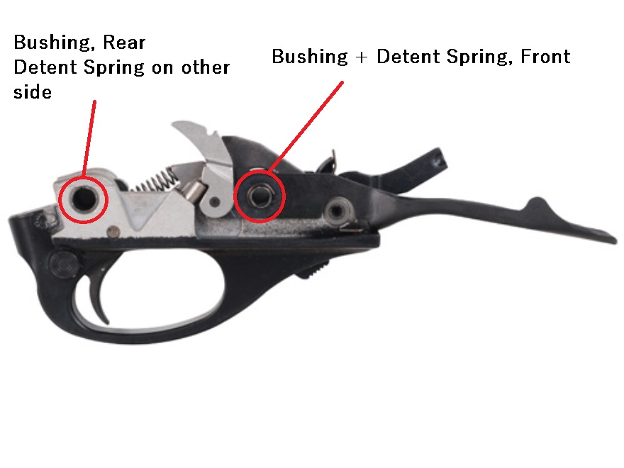

The front and rear pin will sit inside of a trigger plate bushing ("sleeves" hole for the trigger pin to center the trigger assy with the receiver) and a trigger pin detent spring to secure it in place.
I would be willing to bet that both are still present in your trigger assembly. If not, ebay.
And yes, 100% you would need both a FRONT and a REAR, the rear pin is wider.

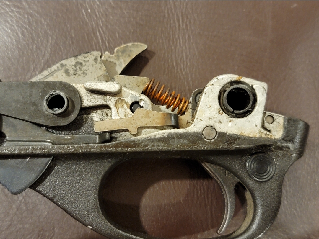

@doom720 - Super helpful! I'll go yank out my trigger and compare to your drawing. I know I need the pins. This a match pair of 870p's - both had side-saddles (one is missing, but has the plate), so both are bolted on right through the trigger housing. I know I'll need pin set...stand by. :-) I did notice the price of a trigger housing. $100+!

Those are pics of my dirty trigger...other than pins, am I missing something? I'm planning Cerakote both guns. That park is pretty marked up

JeffCooper wrote: Sun Oct 03, 2021 2:06 am Those are pics of my dirty trigger...other than pins, am I missing something? I'm planning Cerakote both guns. That park is pretty marked up
Looks like you have everything minus those pins.
