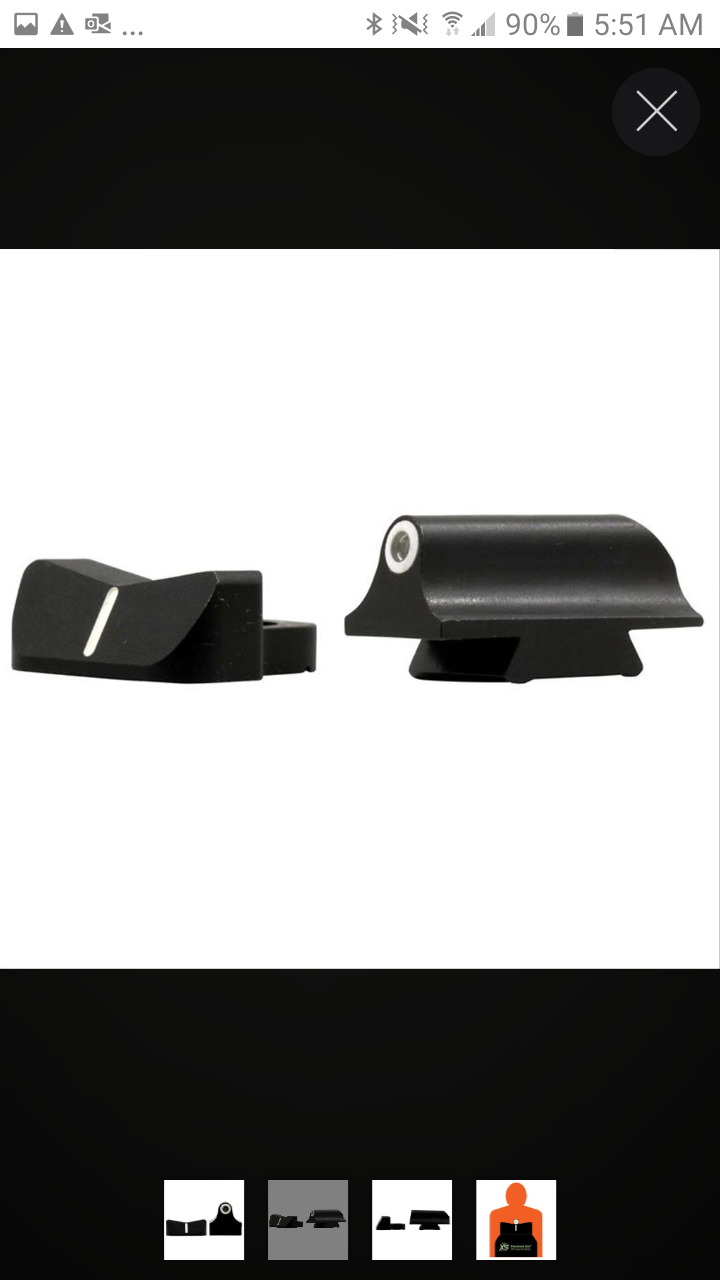

My tritium sights are XS. The front has white circle around the lamp, and it stands out pretty well.

Not 100% sure about rear, but front has XS logo embossed on front. My rear sight looks like a standard Remmy rear iron but with a dot on either side of notch. I like the rear that comes with this XS set better.

It'd be nice to have the rear sight have (2) sides lit up. My stock rear sight has a small white arrow in the center - I can barely see it.
In the front, I have the one small white dot facing me. Can barely see that. The one thing the gun does have is a natural aiming feel. You get the stock to your cheek and it lines up the sights pretty well.
I do not want to block my line of sight. I think it would be nice to have the rear sights be lit up on each side and the front lit up - all small 'lights'. I think green would work for me.
