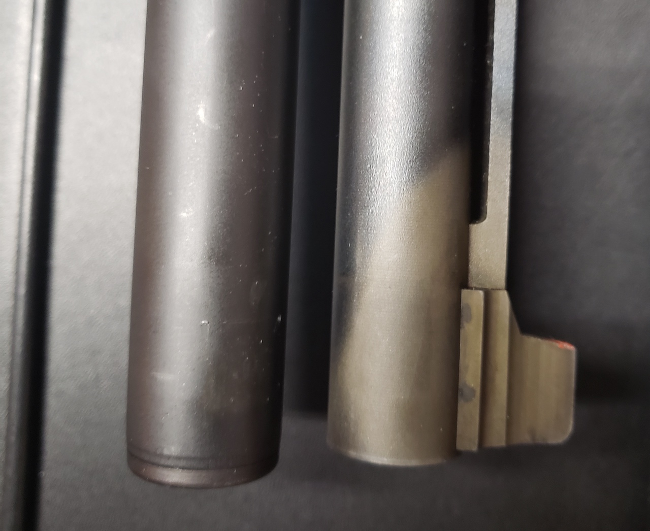

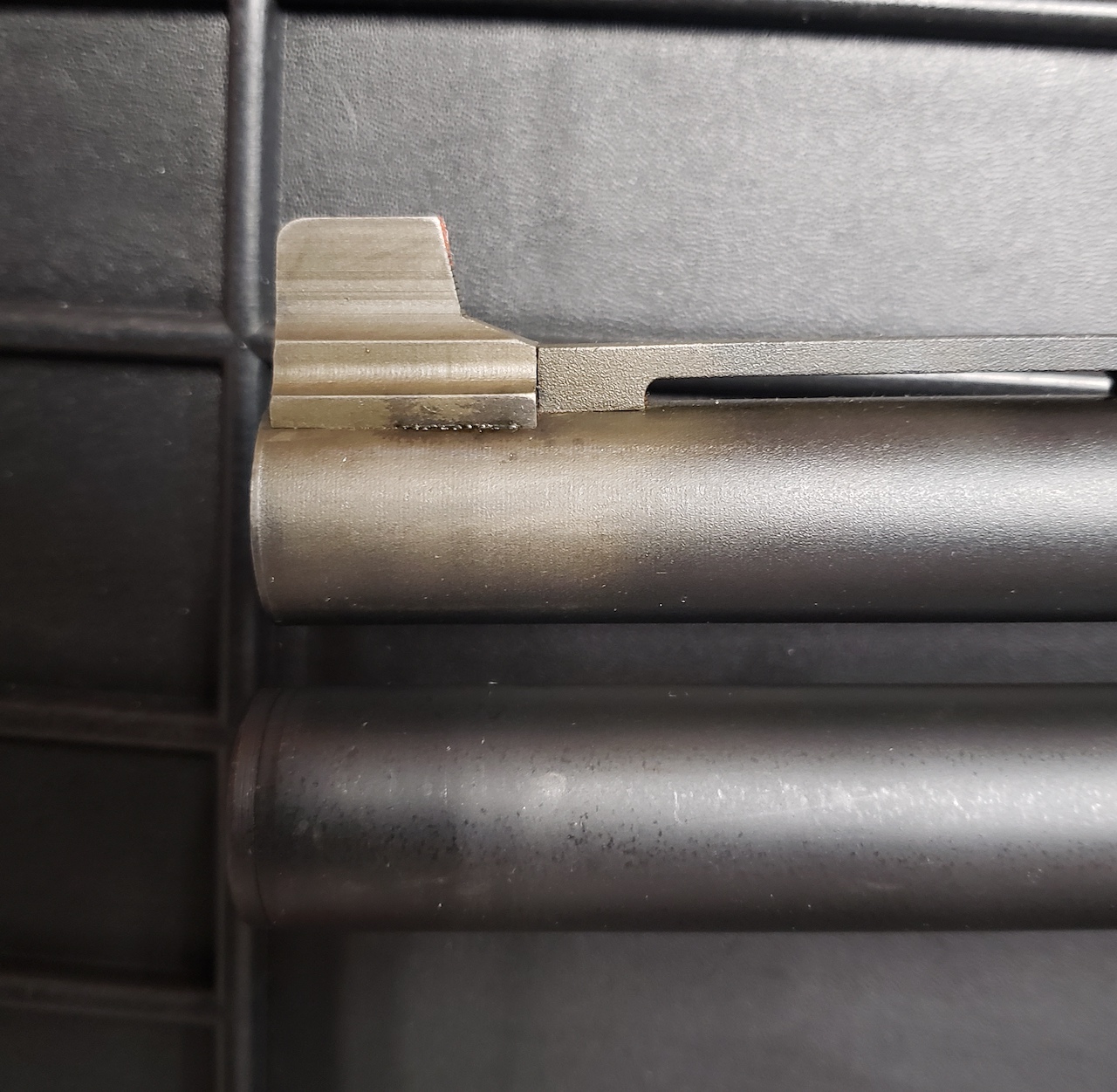

Hi
Bought a used express magnum and I am wondering if this is rust or the bluing/finish wearing off? Also Is there a simple way to fix this or does it need to be reblued? I know that this is merely cosmetic and doesn't effect performance but I am curious thanks
I tore the gun down and gave it a deep clean as it appears to have come from a smokers house. Thoughts and advise appreciated.

The barrel was likely shortened. Then the rib was cut short, the front sight was soldered to the barrel. The heat of soldering discolored the finish.

ChillyB wrote: Wed Jan 06, 2021 12:17 am If mine I'd accept it as is. If it annoyed me too much I'd have the gun parkerized, or cerakoted.
Try rubbing some oil into the finish as if it was Parkerized, which is almost what the Express nitrided finish is close to. Rub some Ballistol in and let it sit. That looks like heat discoloration to me.

thanks for all the replies. I will try a little oil and see what happens.

Scorpion8 wrote: Wed Jan 06, 2021 2:40 am
I dont think Express is nitrided. At least not any nitriding I'm accustomed to. Nitriding is more rust resistant than even hard chrome, and very high surface hardness. It's a terrific gun metal treatment, way better than I'd expect on an Express. I think Express black is likely the least expensive treatment that makes metal black. My guess is a blasted surface ran through the same bluing process as the rest of their guns. Wouldnt that make sense if Remington already has bluing process lines? Use what you already have, save money by eliminating the metal polishing.
