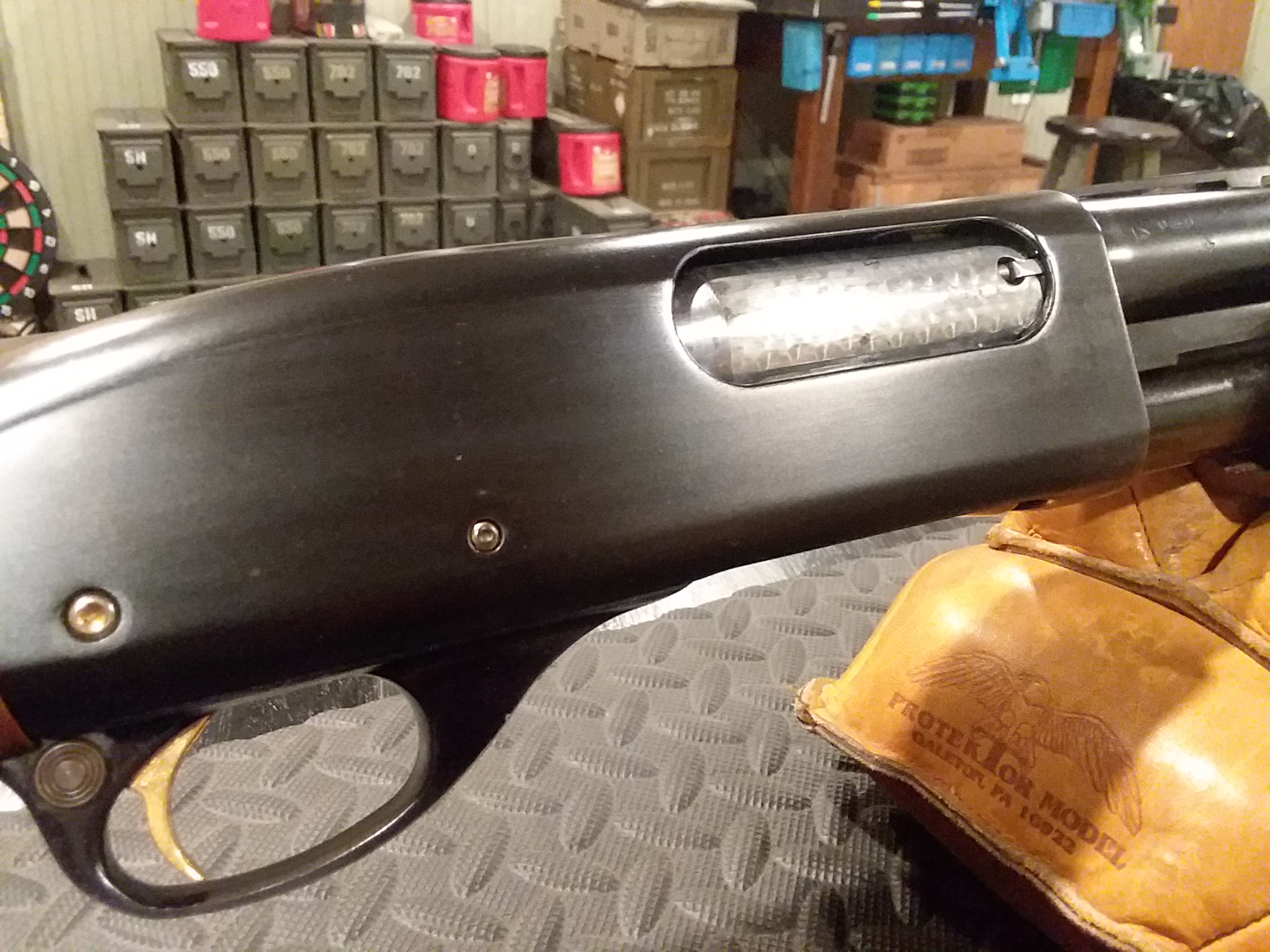

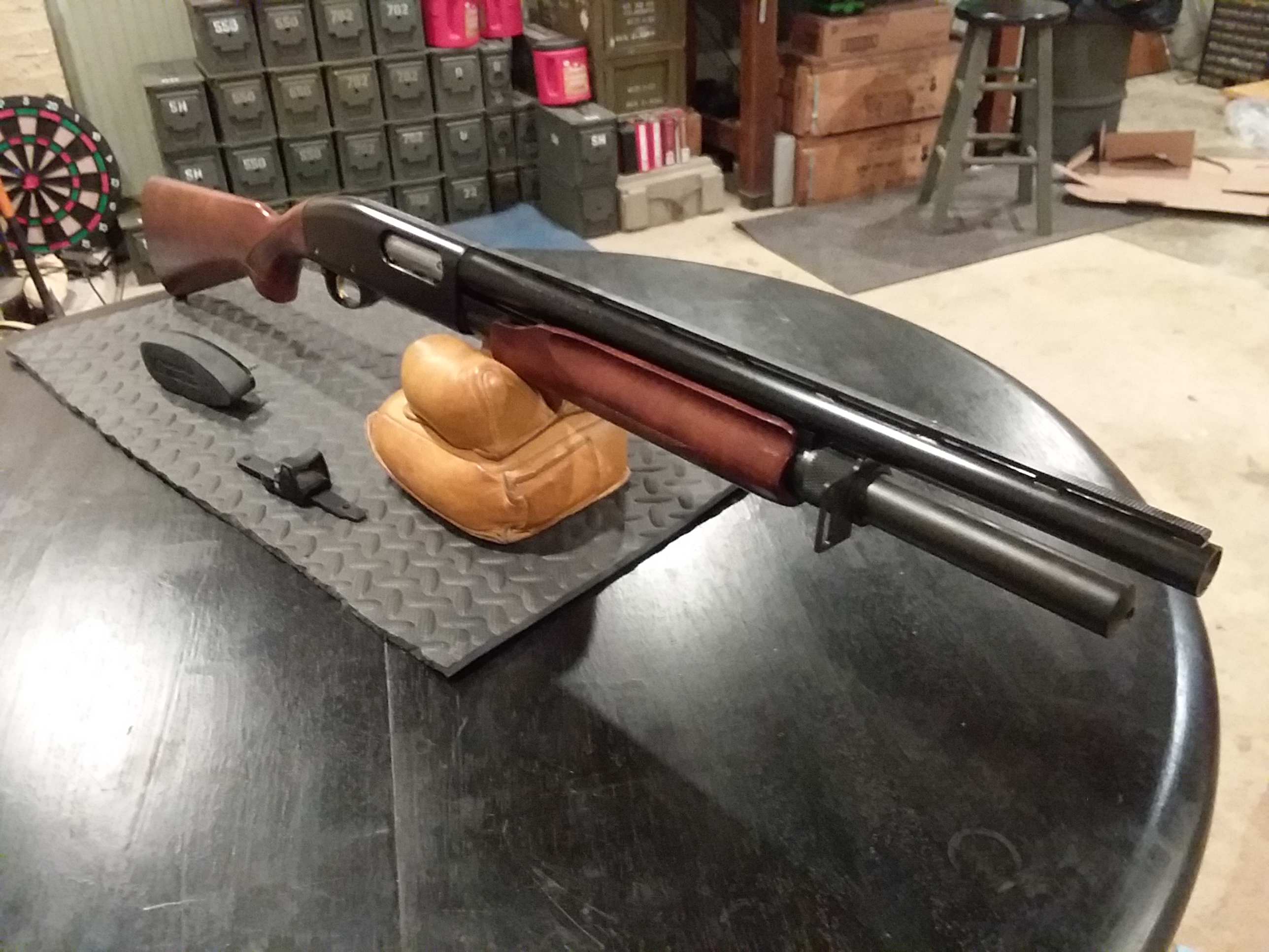

Here is my finished 870 TX. Slow Rust blued with Laurel Mountain Barrel Brown. Took about a week, maybe 5-6 treatments

Looks great! Is that a cold blue process?

Maybe? I consider "cold blue" to be the wipe-on wipe-off chemicals that give instant gratification and long term regret.
This process is s slow rust where the chemicals produce a velvety red-brown rust. Then you boil to convert it to black, then you card off the velvet. Repeat until you swear next time to pay a gunsmith for hot blue job.
Supposedly this is the most durable form of bluimg, and was the standard method in early half of 20th century.

Scorpion8 wrote:Looks great! Is that a cold blue process?
Nah. Those are two are not the same.

If question was to inquire whether the process requires special equipment and chemicals like hot caustic salts then it does not. I suspect hot bluing was developed to productionize the process and result in high gloss finish, not because hot bluing was superior. My interpretation of a short amount of study, not significant experience.
Slow rust bluing isnt hard. A friend once stated there are no easy jobs or hard jobs, only fast jobs and slow jobs. This is a slow job.
