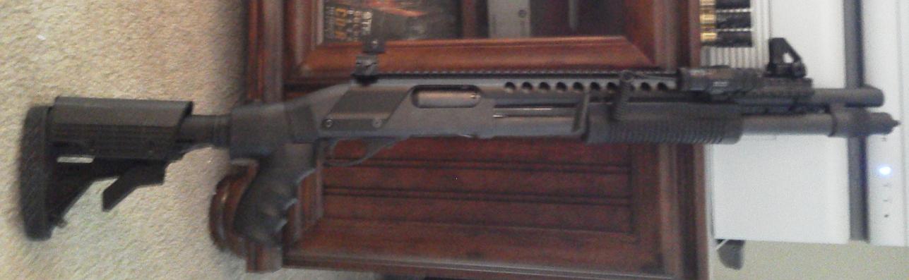

Picture shows all attachments except weapons light on opposite side.

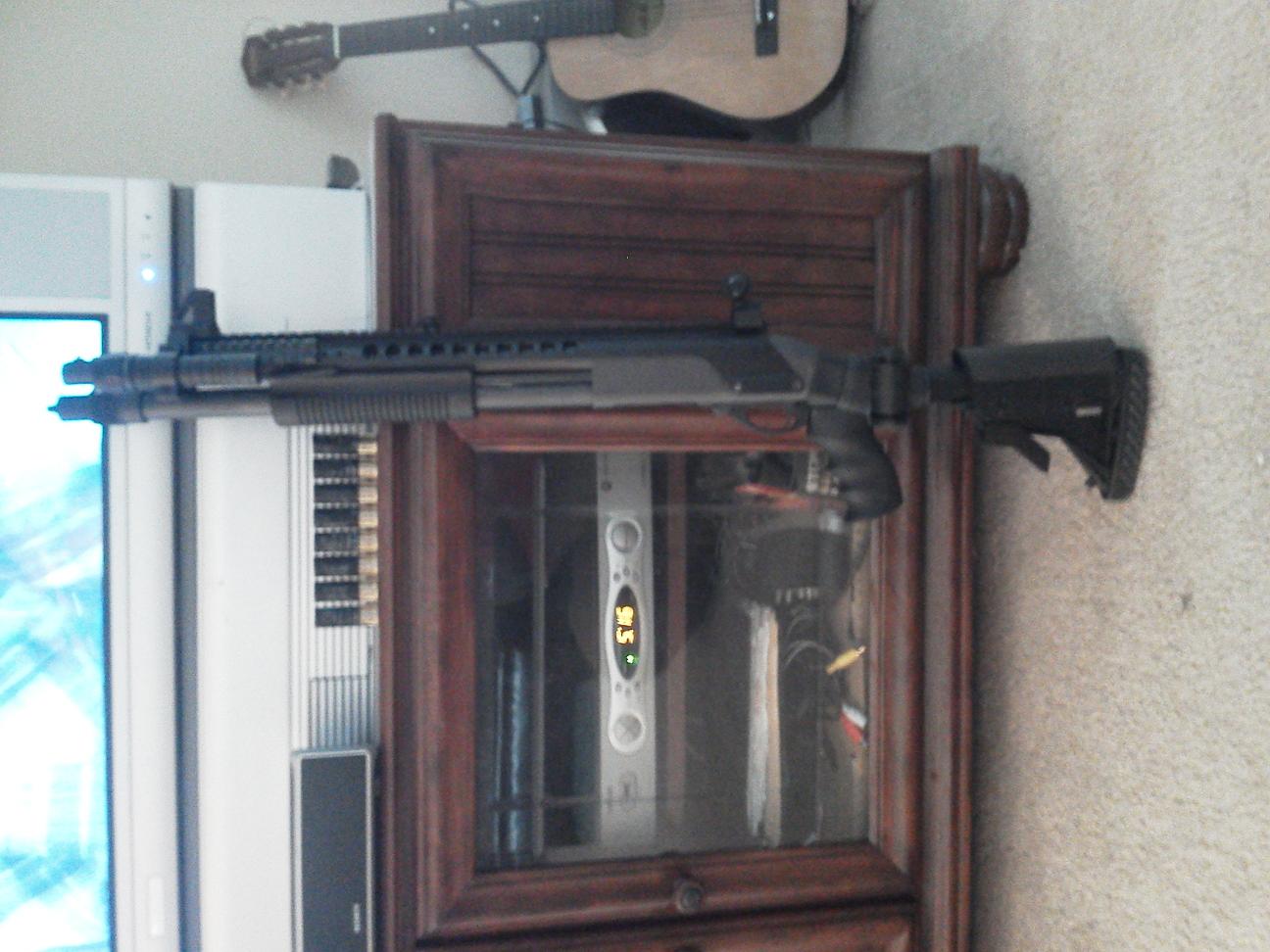

The other side, shows Sight-Mark 260 lumens weapons light
