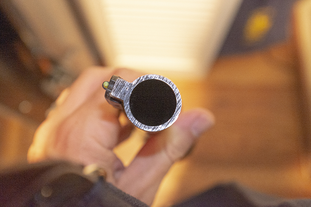

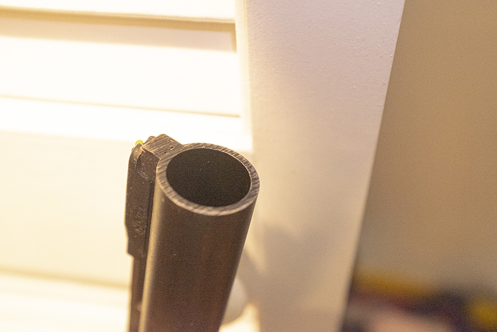

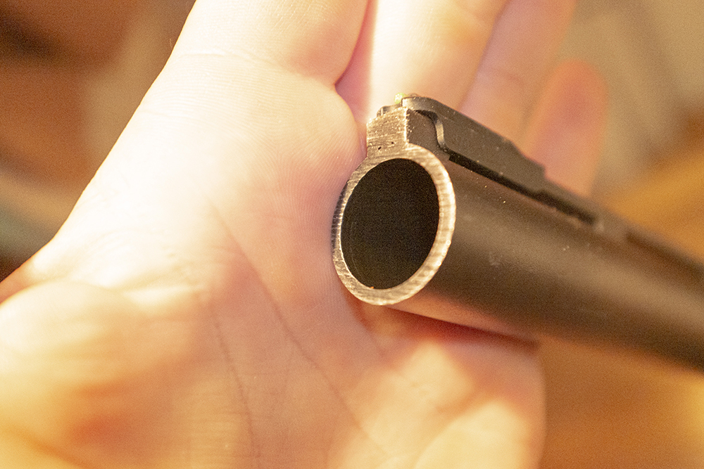

Second, the barrel has no choke and isn't threaded for one. So I want to be sure I'm purchasing the correct slugs for the set up I currently have. I'll attach pics of the barrel for reference.
The barrel length is exactly 18".

As that barrel appears to have sawn down and the crown hand squared by file, it is almost certainly cylinder bore, unless it was a full choke 21" turkey gun, in which case some residual choke might be there, but minimal. You should be able to shoot anything from slugs to buckshot to bird and target loads. For home defense, it depends on the typical engagement distances inside your dwelling and how far your neighbors are. Apartment, I'd go #4 buck or even BB birdshot. Big house on a big suburban lot, then 00 buck and even slugs. Just don't miss.
Now, since I think that barrel was cut and crudely re-crowned, make sure you pattern your gun. If the patterns suck, take it to a reputable smith and have him square and recrown properly. Repattern again and you should be good to go.

ETA:. I missed where you said in your original post that the barrel is exactly 18". Forget what I said about proper recrowning, that procedure might bring it below 18" and make the barrel illegal. Shoot as is. For home defense purposes at home defense distances it will be fine as is.

I remeasured the barrel this AM (after watching some youtube vids) and it comes out right at 18 3/4, so there is a little room to spare.
