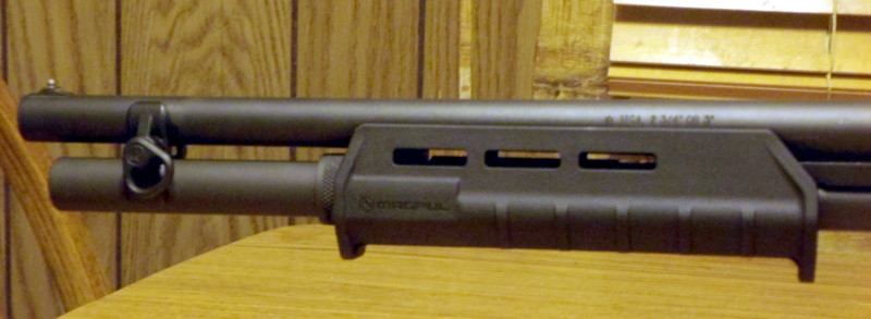

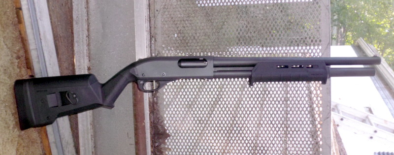

Just to let you know, the last time I bought a Remington +2 mag Extension was on Ebay. It's pretty amazing that if you keep up with searching Ebay from time to time, you can find just about anything. BTW, I have a Wilson +2 Mag Extension that I no longer use, in Brand new condition. I think I even have the spring to go with it. Wilson makes a good product, just saying. If you're interested or want pics just let me know. Good Luck.
