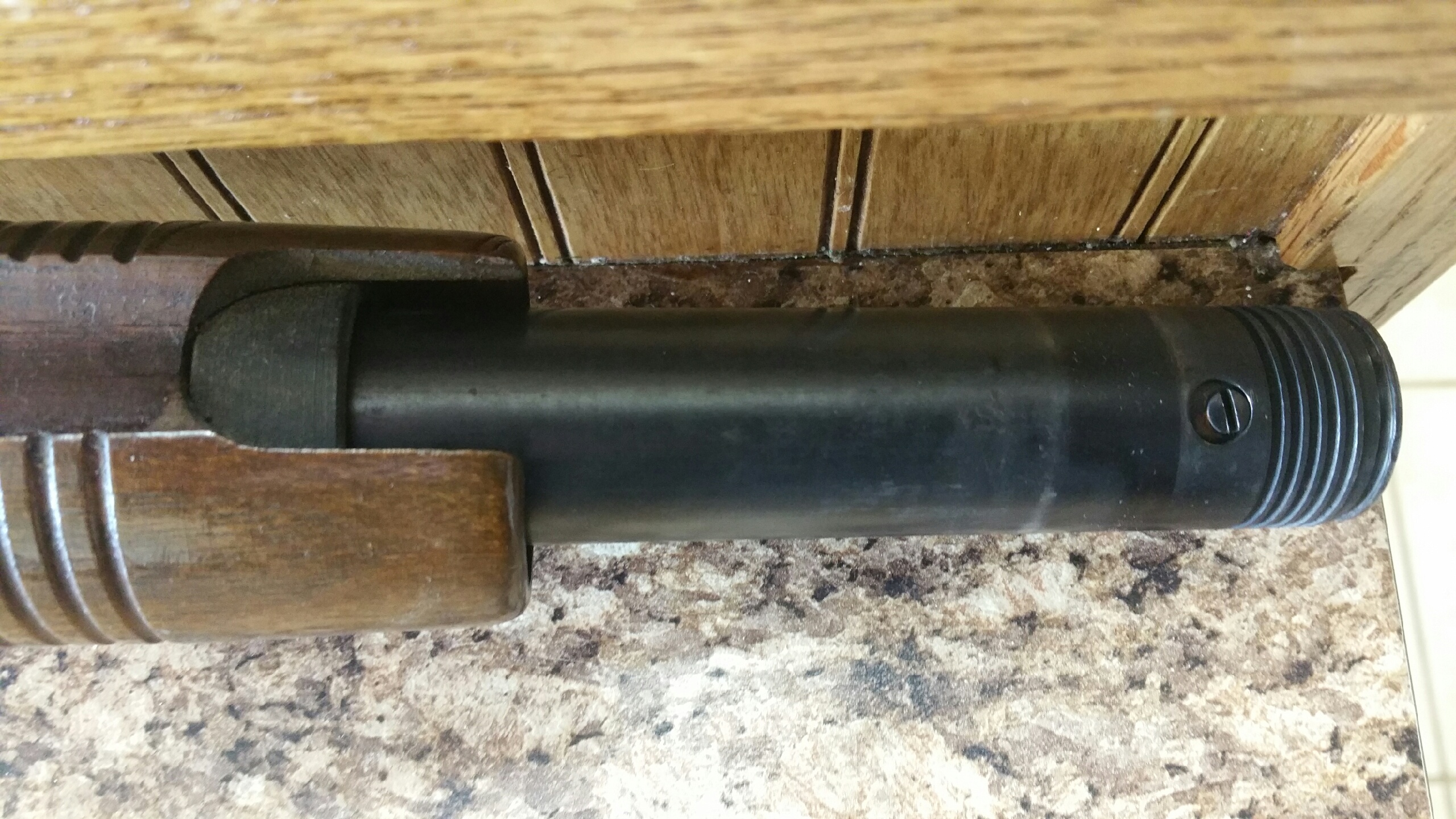

I'm rescuing a 870 Express Magnum 12 ga. the mag tube was buggered. I have straightened and got dimples and dents out BUT the threads were "compressed' at the end, during the original damage. I'm sure a die would clean them up, the tube straightening and punch and hammer work have it all straight. Another fix would be to mill or file the 1 and 1/2 threads off that are buggered. Because I can not find a 1" 12 pitch single lead , flat thread die! Where would one purchase one of those?

No, magazine tube threads are square threads not 60deg v threads. As where to find a die, i have never seen a die for square threads.
It is possible to repair square threads with a set of (swiss) needle files. If it is just the first thread i would simply cut it off if you can not repair it

Thanks. that leaves 3-4 threads for cap to attach, enough?
Banshee
Posts: 398
Re: 870 Magazine Dimple Removal Fail Help
Post by Banshee »
Well, we put sling plates under the cap all the time with no problems and that shortens the tread length. I would try repairing them with a couple of needle files first and remove the bad thread as a last ditch effort.I have repaired some pretty rough threads with files. You can get a set of files from Harbor Freight for less than $10. They only have last long enough to fix your mess. Any pictures of the damage?
