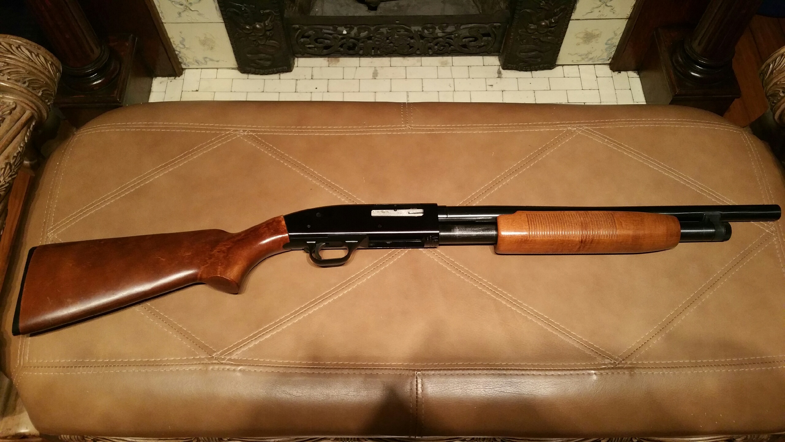

Re: Mossberg 500A Project
Here's mine, also Plain Jane...
and
Oddly the wood looks mismatched, but it's not. I've seen that in 870 sets also. 4+1 rounds capable, I do love the barrel, but not in love with the (rather) flimsy receiver.
and
Slug barrel on the 500?Scorpion8 wrote: Wed Apr 22, 2020 3:48 pm Here's mine, also Plain Jane...
and
Yes, with rifle sights. Receiver is D&T for scope mounts but I'll let someone else put them on. Its for sale locally.
