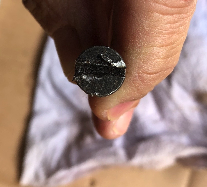

Cobbled together some adapters so I could use my hollow ground bit with my ratchet and get more leverage than my screwdriver. Broke free and a little resistance backing it out. Cleaned up the threads and now it threads freely. I'll look into replacing the 8.5" screw.
Like to swap for an allen head and Brownells doesn't show a replacement, any suggestions there?
Screw Head.jpg (121.09 KiB) Viewed 3580 times

Good job getting that broken free. Yea, sometimes ya ruin one. Check Remington's website for that part, or you might take the old bolt to a hardware store to match threads and see if the have a long bolt or piece of all-thread that you can make work.

Go to Tacticalgunslings.com JD is probably one of the best 870 guys and keeps a lot of parts in stock at fair pricing (AKA AI&P tactical).
