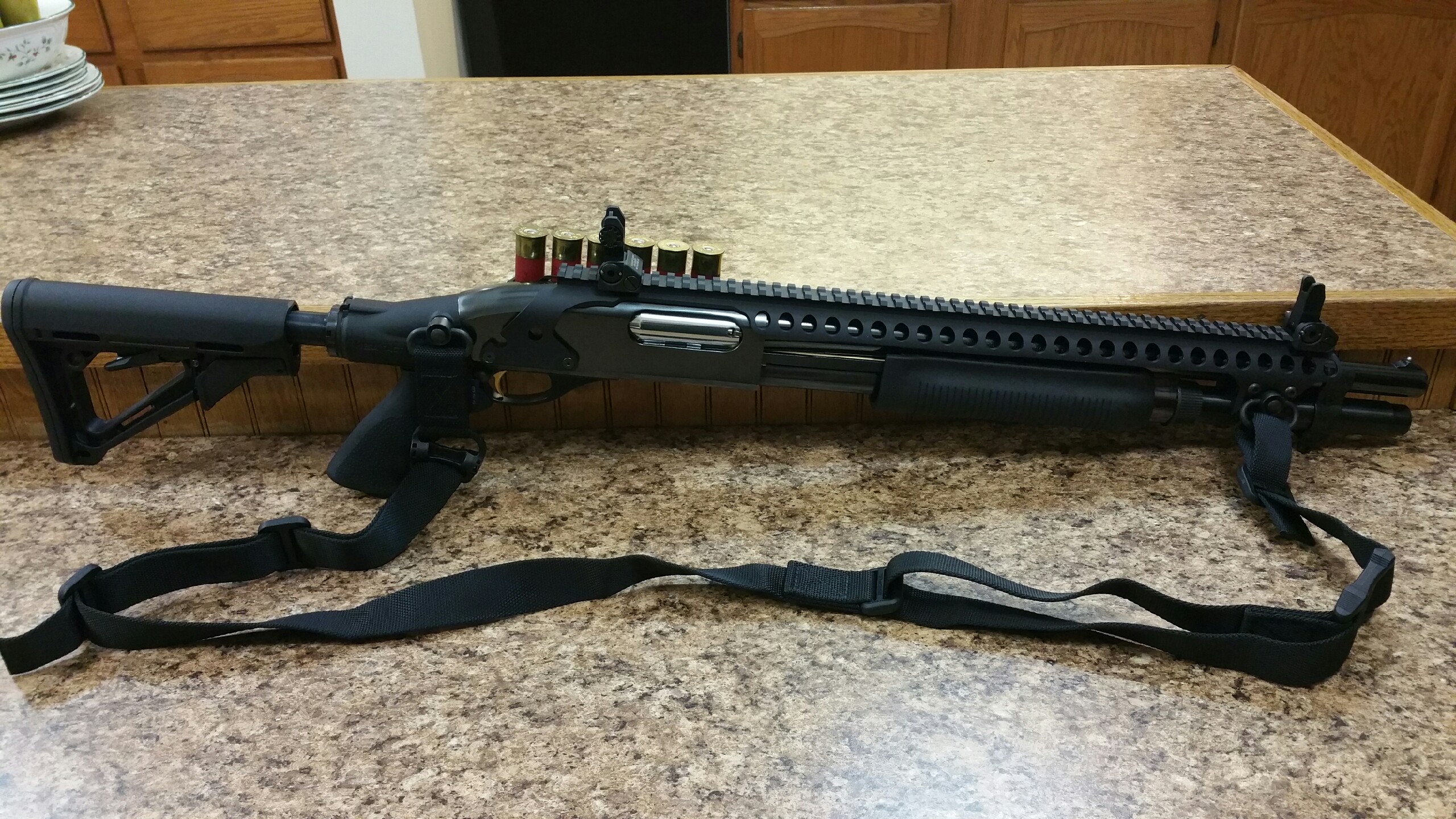

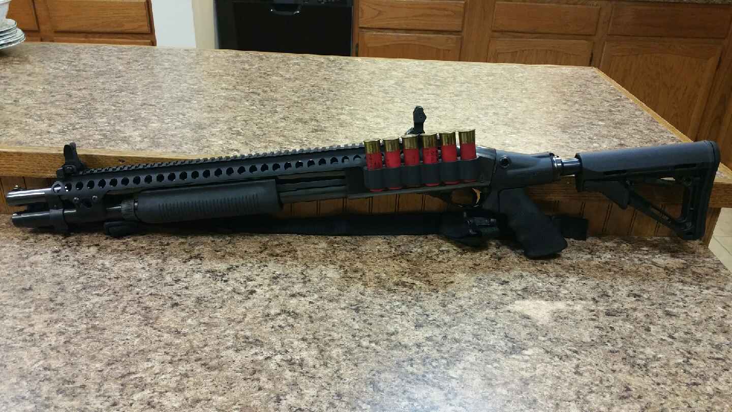

Personally I think you are completely overthinking this. Some tactical shotgun builders claim the polymer trigger group is better to use and will give reasons pro and con for both. Ask 10 people what the best pistol is and 9 will tell you Glock. Ive used both aluminum and polymer there isnt one bit of difference.
If you want to jazz it up use a Wingmaster trigger group with a gold trigger. Both have been hunting, shooting, killing, protecting for YEARS. This is my last build I used a Wingmaster trigger group with a police sear spring, 1100 carrier spring, and a jumbo head safety.

Like I said in my original post, my reasons for wanting a steel trigger guard are almost entirely subjective, so there's 0 chance of talking me out of it. If someone convinces me that it's nearly impossible to convert an 11-87 steel trigger group to fit in an 870, I'll probably just buy an aluminum police trigger group. The only benefits that polymer has over steel in this instance is corrosion resistance and lower density. I don't plan on getting an acidic solution on my 870, so corrosion isn't an issue for me. I'm also not a very big guy, so reducing the weight of my 12 gauge isn't something I'd care to do. I use this shotgun mainly for home defense, so I only ever shoot 00 buck or slugs through it. I prefer to keep my shoulder in its socket. Thanks for the reply. On a side note, what heat shield / sight rail is on the gun in the photos you posted?

The sights look like Magpul Mbus flip ups to me. Can't comment on the rail.
