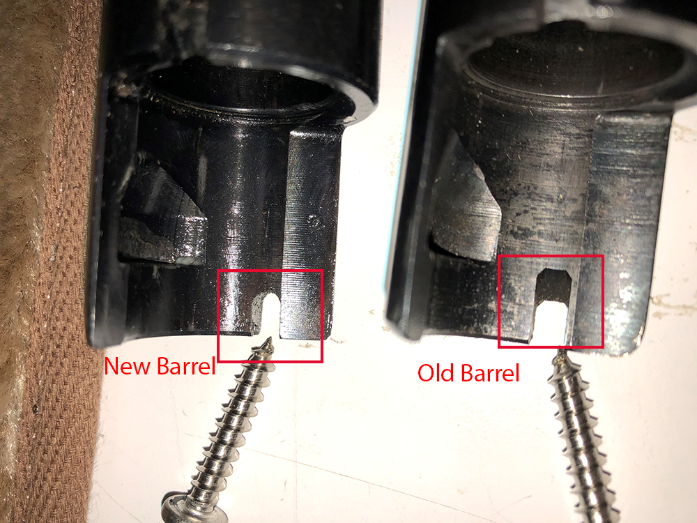

Okay,
Made some progress. Installed the new wood forend and I'm still having the problem. So I compared the old barrel that worked with the new barrel that sticks.
I've been trying to find closeups or blueprints online. From what I can see, the new barrel is improperly machined. I'm reaching out to Remington re: a replacement barrel.
What do you think? If you have a working 870, please take a quick look and see what your slot looks like. I'd be interested to know.
Thanks again for your comments.
