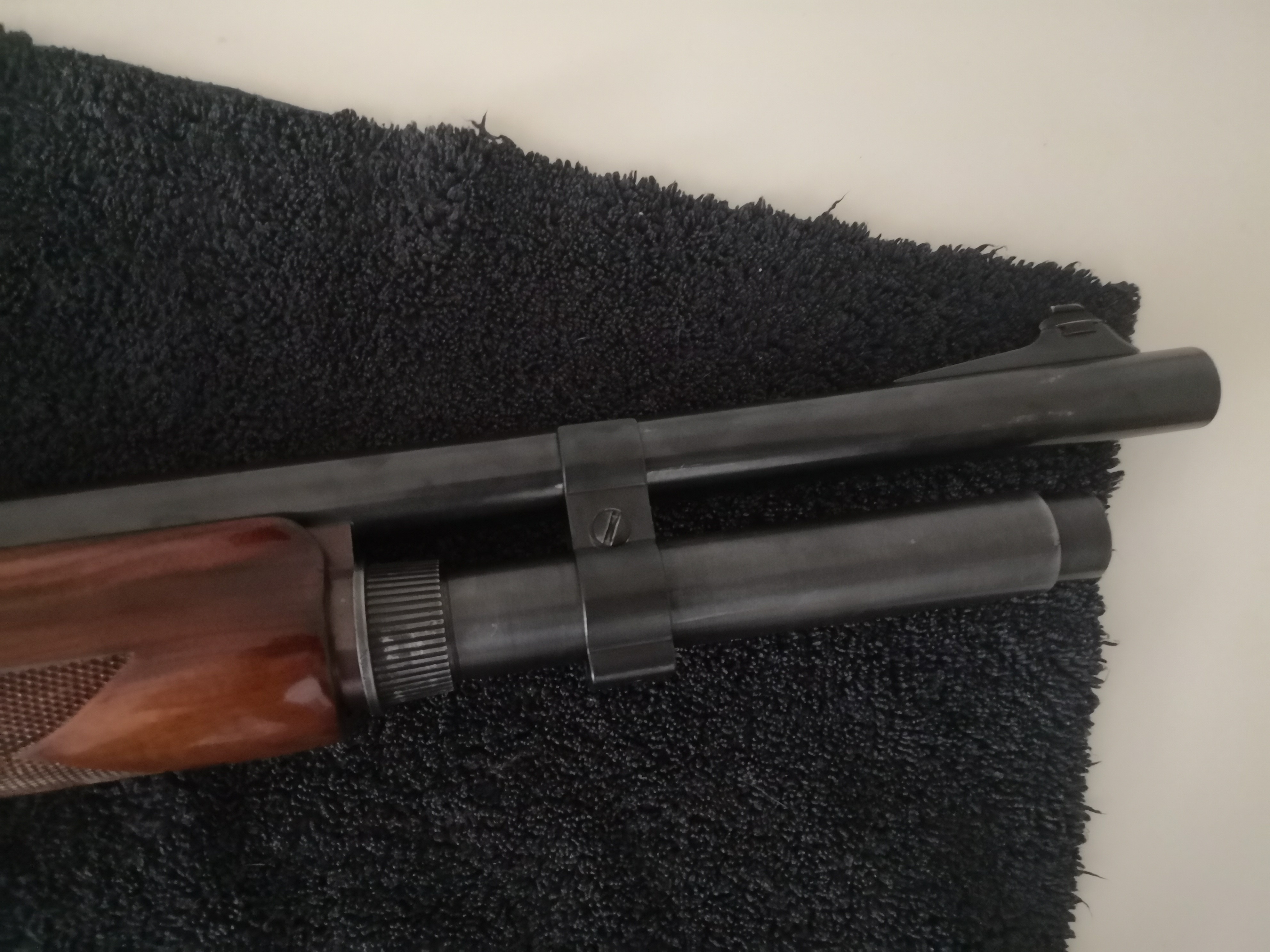

I need your knowledge! I can't find anything on the web; do you know that there was in the 70s/80s a tube magazine extension remington manufacture of a cartridge only? Have a nice weekend
old kit extension magazine +1 manufacture remington

Is your question where to find a +1 extension? If that is what your after Wilson Combat sells a +1 for $45.

Hello,the above extension is different from +2. the stop is shorter, I can load 5 cartridge in 70mm. My question is know this is a kit extension +1 tube. Can be in the 70's remington manufactured? it's a mystery!

Offhand that looks like a +2 extension. Did you pull the spring, magazine follower and spring retainer to see if there is something blocking +2 and limiting you to +1? Some magazine followers have "tails" that may be long enough to just inhibit a full +2.gipsysoundclash wrote: Sun Nov 03, 2019 9:59 pm Hello,the above extension is different from +2. the stop is shorter, I can load 5 cartridge in 70mm. My question is know this is a kit extension +1 tube. Can be in the 70's remington manufactured? it's a mystery!

Scorpion8 is correct that is a +2. Something is hanging up and/or jamming. Remington +2’s are all the same from the 1960’s to the current day the only thing that changed is the barrel clamp in 1990 and you can tell because the 90+ have an ‘X’ stamped on the and the ‘89 and earlier don’t.
Make sure you use the right clamp on the right barrel.

hello yes I checked everything several times. I am not not enough space to retrieve the 6th cartridge the Bute followers on the follower stopping. besides that d i compare my trailing stop with extension +2 remington, it appears that my trailing stop is positioned much more short! What do you think ?

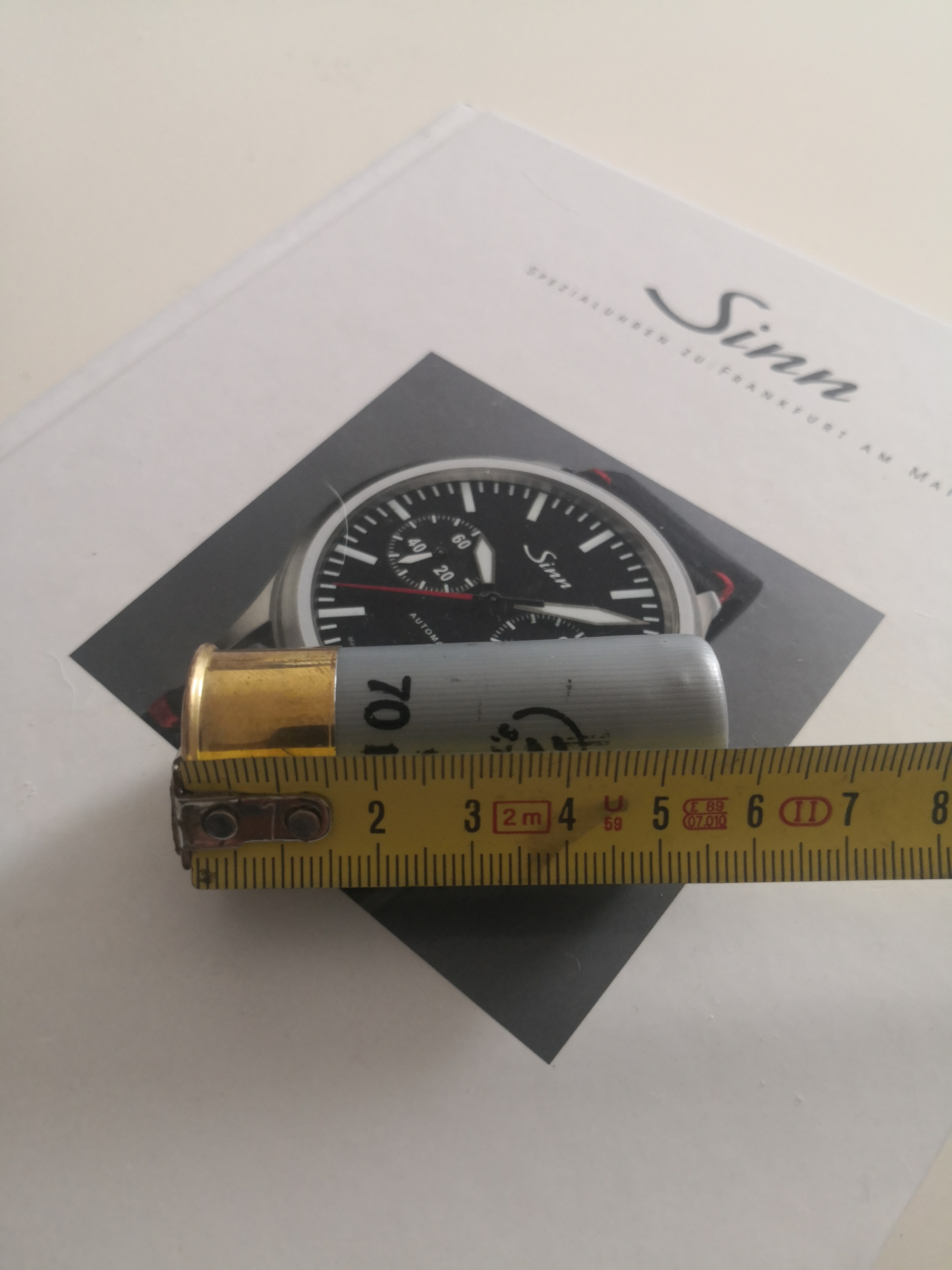

there is not much left to introduce the sixth cartridge! maybe my 2 3/4" - 12/70 cartridges are too long? they are 1.9685 inches.

gipsysoundclash wrote: Mon Nov 04, 2019 11:55 am IMG_20191104_141116.jpgthere is not much left to introduce the sixth cartridge! maybe my 2 3/4" - 12/70 cartridges are too long? they are 1.9685 inches.

hey good evening guys!
give me you're feedback between my extension remington magazine between a another picture with kit remington factory extension tube magazine +2.
it's not a same piece accessory!
>> my Follower stop is more ready mag plug. I do not understand I can not find anything comparable identical on the web.
I removed the spring and introduced 6 cartridge + the follower and I reached the end of stop helps to prevent spring over-compression.
