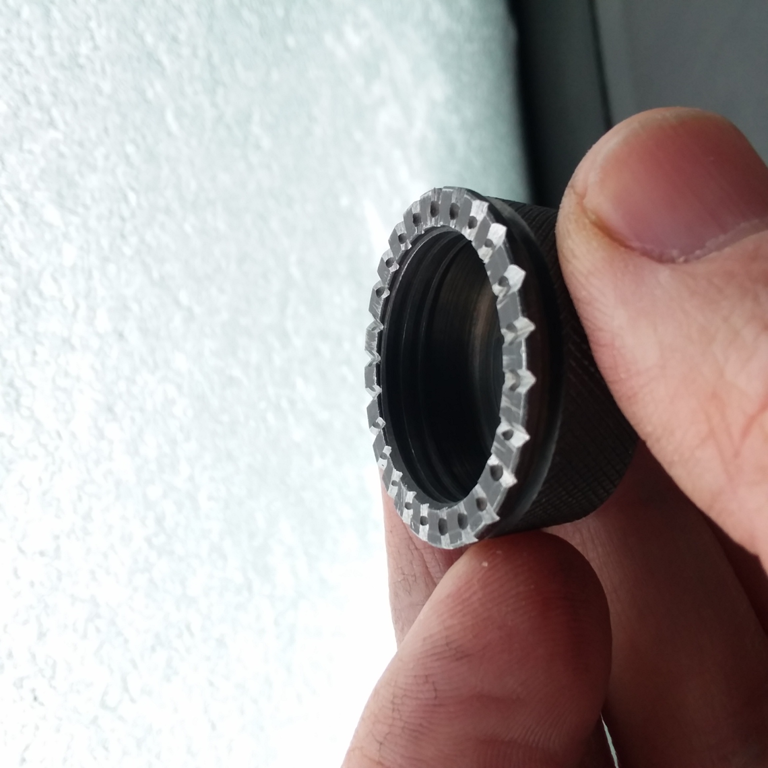

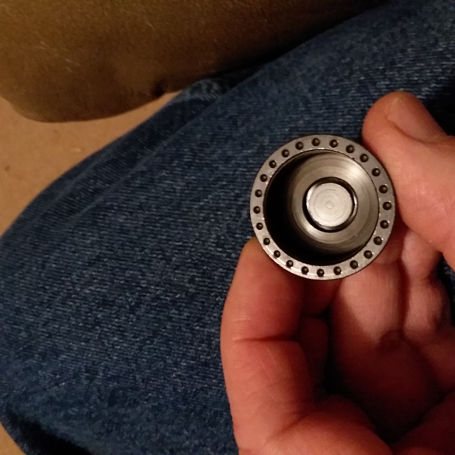

Post by Chilly »
Installing an Uncle Mike's sling swivel mag cap on a mid-80's barrel. The detent pin barely touches the detent holes in the cap. You can see a shined line near my index finger where the pin rubs outside the circumference of the hole pattern. I'll fix this with a small triangle file, cutting a shallow notch radially across the divots. If one doesnt swap barrels you really only need to do this to a few spots in front and behind the last engaged divot.

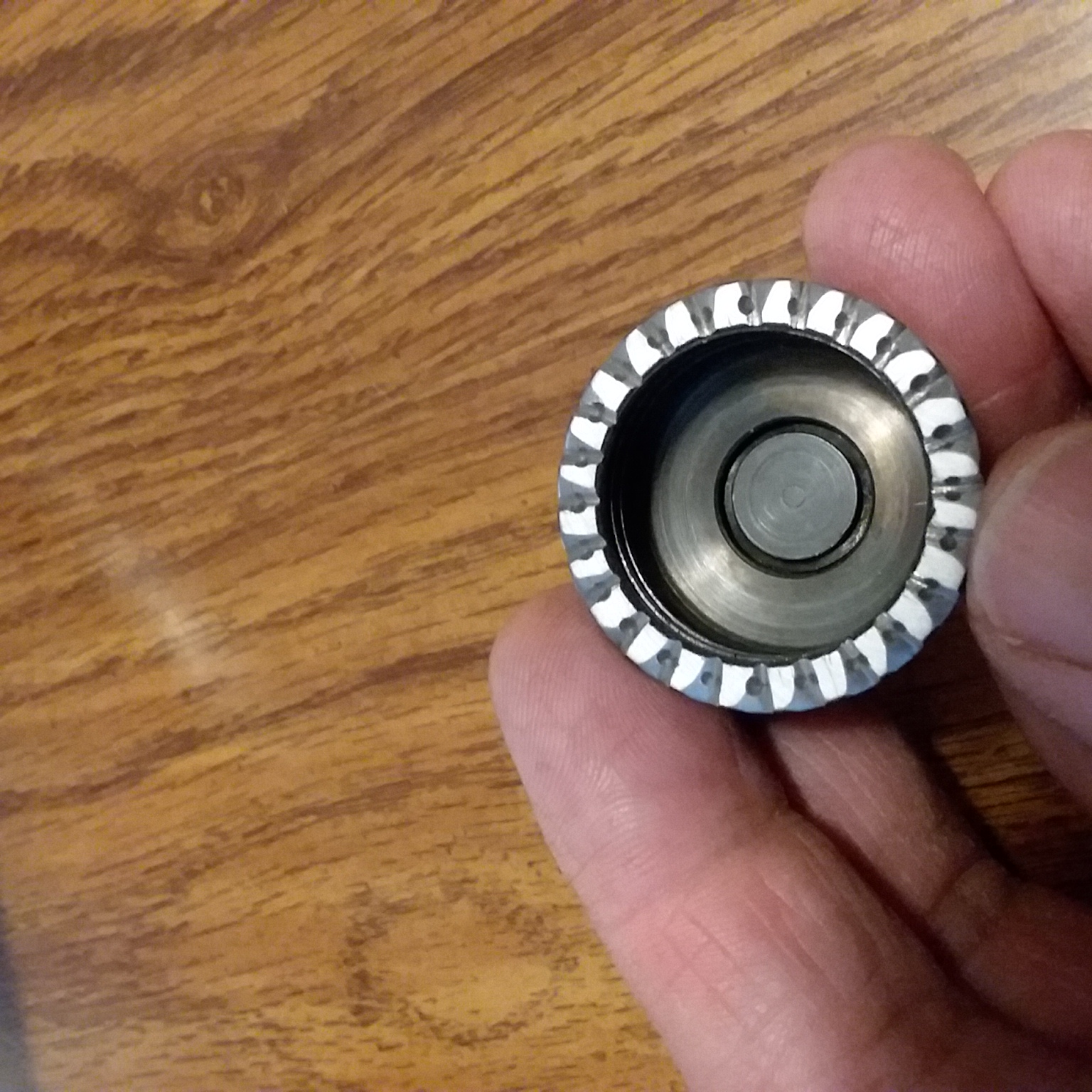

Using a triangle file I grooved to approx the bottom of each divot. Then, thinking that was a rather narrow and sharp groove, I followed with the corner of a small square file.
Posts: 245
Re: Mag Cap Detent Misalignment
Post by Germansheperd »
Good work. That will do the job!

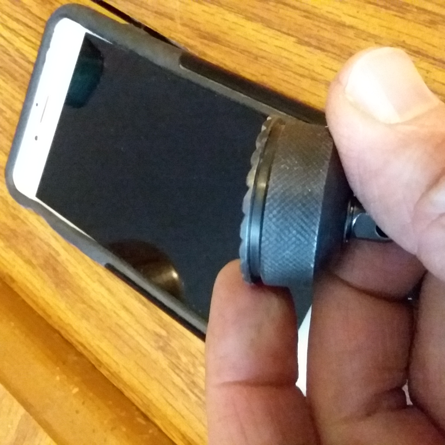

Feathered the notch edges so it'll spin on easy but offer more resistance when loosening.
