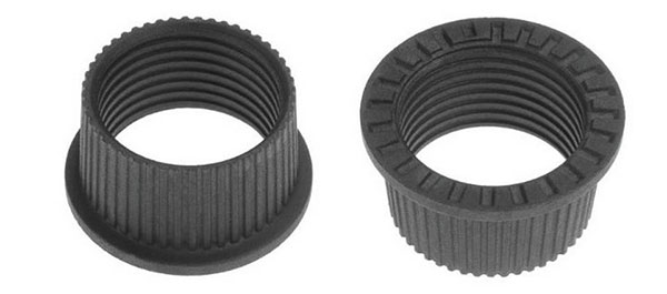

I own a 1994 Marine Magnum, and upon previous disassembly I have noticed that the bottom end of the mag extension coupling reaching the barrel support ring upon screwing has a rather deep indentation all accross its radius - probably created over the years by the "click-ing" contact with the ball bearing at the edge of the barrel support ring.
I just want to know if this wear and tear situation could pose a problem to the overall functioning of the shotgun and if should it require a new mag coupling. Note I have never fired it before.

As long as the nut snugs up and stays snug and the barrel isn't lose you are fine, but if you wanted to replace it, it probably wouldn't break the bank.

I have tried to attach with no success a couple of photos showing the state of the rectangular notches at the base of the coupling - the wear is visible - there is a deep groove made by the ball bearing all across the notches and it stops half way to the top of the last notch when screwed all the way to the end.
When the coupling is screwed on top of the barrel control ring, the barrel has a slight sideways rattle only to become snug fit when the coupling is tightly screwed and the ball bearing climbs on top of the last rectangular notch causing a slight misalignment with the barrel ring or when the mag extension is fully screwed on top of the coupling.

Is this the part you are referring to that is damaged and needs to be replaced?

This is it, but the electroless nickel plated version for the Marine Magnum.

Ok that is the part I thought you were referring to. It’s fairly easy and inexpensive to get here in the U.S.
you can order it direct from Remington or use the link below to this other site. He has a wide selection of Remington parts.
