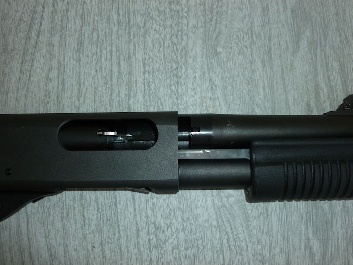

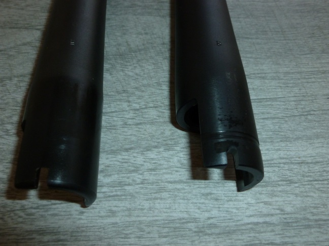

What it looks like is that the barrel ring on the tactical barrel is what holds the barrel on by its tight proximity to the mag cap (extended mag). Since the slug barrel's ring is farther down the barrel, and therefore not in contact with the mag cap, then there's naught to hold the barrel into the receiver.
My guess is that a barrel/mag clamp installed flush to the mag cap is the fix. It just seems a bit... structurally extraneous for such a basic and essential function.

The barrel on the right is the tactical barrel that came with the shotgun. You can see the groove that belts it.
belt groove.jpg (87.25 KiB) Viewed 12393 times
The barrel slides from the receiver quite readily.
Barrel detaches.jpg (126.63 KiB) Viewed 12393 times

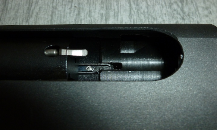

This is how the barrel seats. The barrel itself is tight against the receiver, but the slot is not - it doesn't seem as if this should make any difference..
Receiver interior.jpg (81.99 KiB) Viewed 12393 times

Scotch that. I just learned this about the 870 Tactical: " Due to the location of the barrel ring on this model you can not change to other Remington Barrels as this is the only one made for this weapon."
Now I know.
