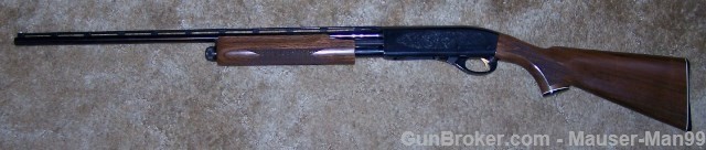

I have a 870 Wingmaster in .410 2 1/2" or 3" shells, ventilated rib, high polished blueing, enhanced engraving, gloss wood. It has the white line and diamond grip cap. It is in really good shape but does not have a date code on the barrel and the serial number has prefix and suffix lettering. Trying to find date of manufacture and more info on it, not having a lot of luck. Any help would be appreciated.

Thanks Sidney, it's prefix is a D so I guess it was made in 2001. Any idea when they quit using the white diamond on the grip cap?
- Remington 870 410 #2.jpg (30.4 KiB) Viewed 10518 times

Thanks, I contacted Ruger and they said it was made in 2003. There's a lot of information on the 870's out there but not a lot on changes in some of the changes.

My mistake not Ruger, don't know what I was thinking. I emailed Remington and they got back to me within 12 hours. A few years ago I bought a Remington 700 and didn't shoot it for about a year and it ended up having a burr in the barrel and sent it back and they repaired it without any problems, maybe I got lucky. But in my opinion Ruger does have the best customer service in the business.
