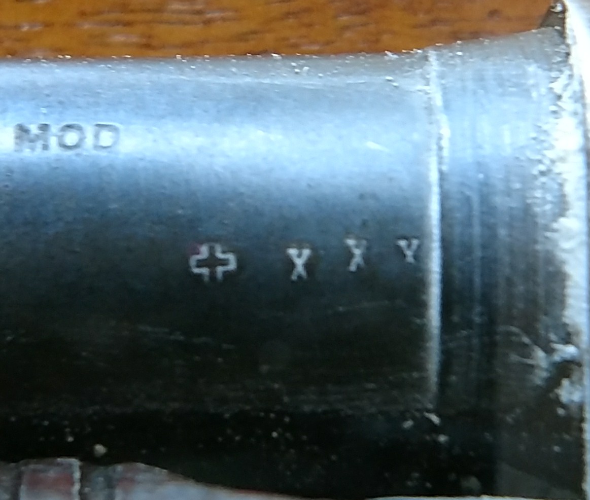

Need a little help from the forum. I just acquired an 870 Wingmaster in 16 GA. I was trying to determine the date of manufacture using the Remington online guide. I may have misinterpreted the guide but was unable to date the three number date mark on the barrel, X X Y. The serial number is 148426W if this helps. Thanks!

Looks like "X X X" to me.
If so, that would be December, 1951. Great early Wingmaster!

Thanks DANNYII. Upon further magnification the marks do appear to be XXX. The shotgun is in about 85-90% condition, found it tucked away with some other old guns at a local gun show. Picked it up for $275.00. I think it was a pretty good deal!
