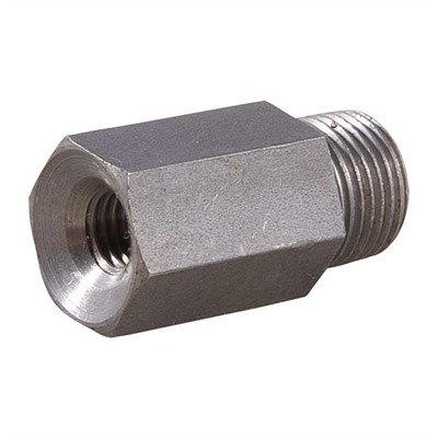

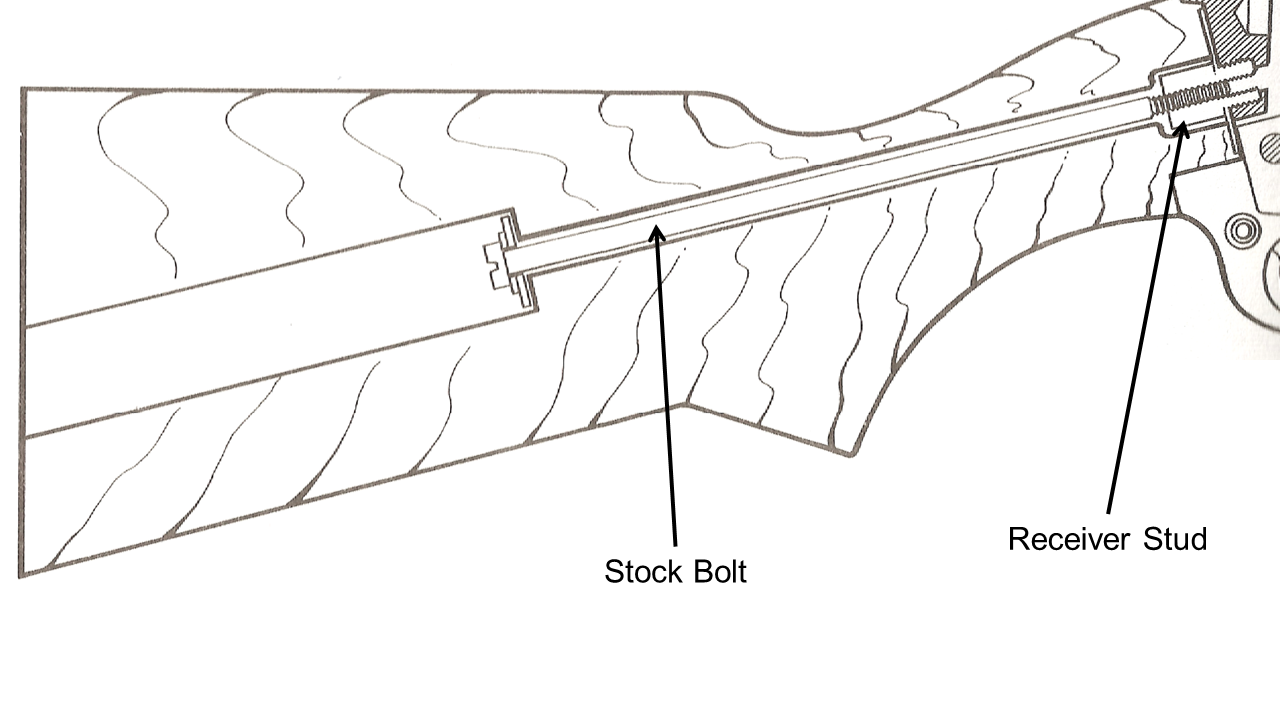

Somehow I missed this post back in 2016. Hopefully you got this figured out, but for the benefit of others, what likely happened is that your receiver stud came out when you removed your Knoxx stock.
The 870's stock bolt doesn't just thread directly into the receiver like on other shotguns. Instead, there's a threaded stand-off called the receiver stud (part #47 in the exploded diagram in your owner's manual) that threads into the 7/16" hole in the receiver, and then the 1/4" stock bolt or screw threads into that. This helps prevent the receiver itself from getting stripped out, makes it so that a too-long stock bolt can't extend into the receiver and interfere with the action, and increases the strength of the joint.
870 receiver stud.jpg (23.52 KiB) Viewed 3456 times
