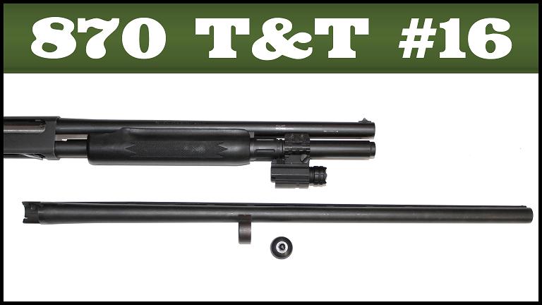

Forgot to post about it here until now, but I managed to squeeze in a second video for 2017, right on New Year's Eve.
Click for video
Click for video
870TT16 Thumbnail 01_C.JPG (32.9 KiB) Viewed 3887 times
This one is about how to remove a magazine extension and switch to a standard capacity with a magazine cap. This might be done to get a lighter and handier defensive build, or to convert a HD or competition gun for hunting. It covers all the parts needed, and goes into detail on cap retention, which I know comes up a lot when folks are looking to take their HD gun hunting. Hope y'all find it helpful.
