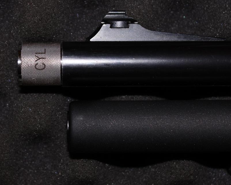

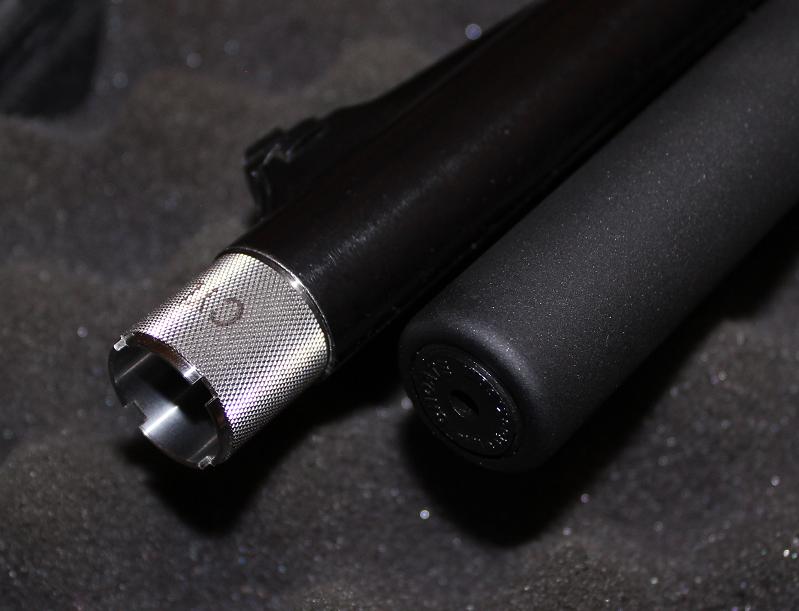

While they're a bit more expensive, what I've come to really like are extended choke tubes. They supposedly pattern a bit better due to a longer conical section or a conical-parallel geometry or something, yadda yadda. What's actually nice about them though is that the extended knurled bit gives you something to grab onto, so you can install and remove them without tools, and without shoving your finger down your shotgun barrel. Also, the extended bit provides a place for the constriction to be clearly marked, and protects the muzzle of the barrel somewhat in case you whack it against something.

Yes, extended chokes are nice for those reasons.
My O/U has one extended choke (the other choke is flush, but I patterned the gun and this was the best combination). I didn't really concern myself that it looks a little goofy :lol: The important thing is it patterns excellent with either barrel
