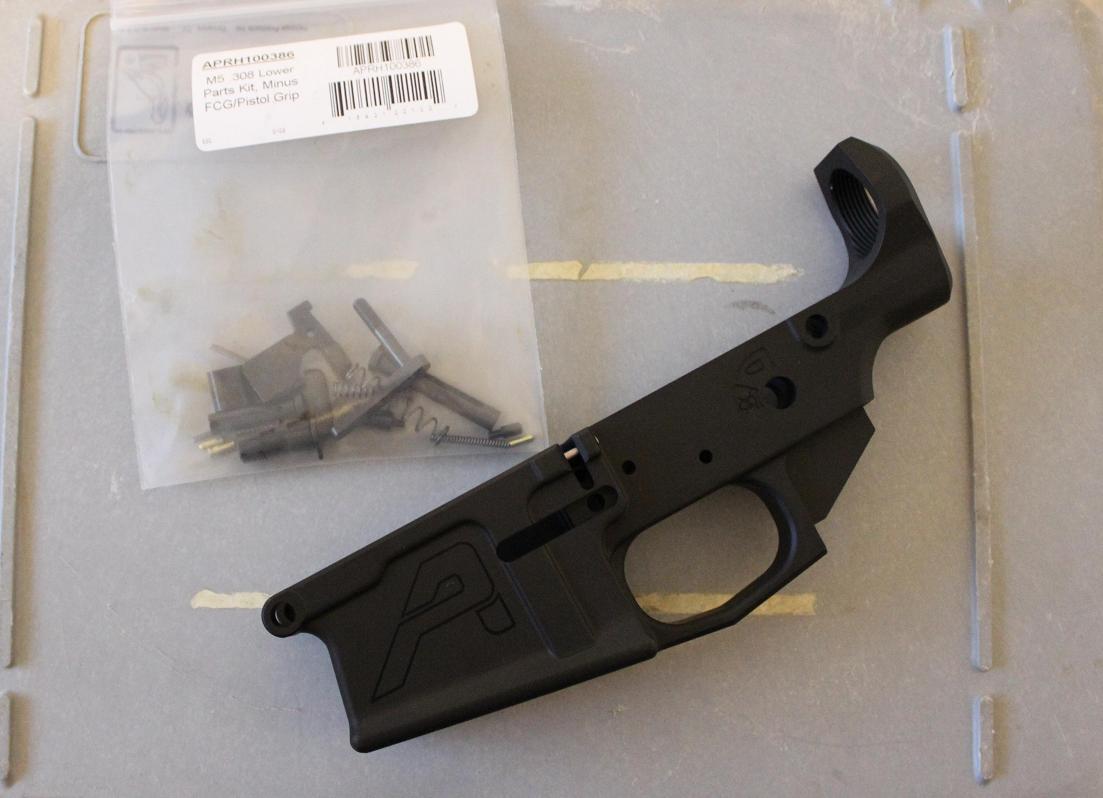

Just took delivery of this today, an Aero Precision M5 lower receiver and lower parts kit. This is intended to become the core of a 7mm-08 AR-10 build (and yes, I know the Aero receivers are DPMS .308 pattern, not genuine Armalite AR-10 pattern, but it's a sized-up AR that shoots a .308-derived cartridge, so I'm calling it an AR-10).
This is a project that I've been thinking about for quite awhile now, reading about AR builds and bookmarking parts & manufacturers that I came across & liked. I ended up with a little more free money than usual thanks to some Christmas gifts, and when I saw that Aero had a good sale going, I decided to pull the trigger and kick things off.
This'll probably be a pretty drawn-out build; one major component at a time as I research things & make up my mind, and as funds allow. The planned end result is a really high-end AR-10 with a lot of nice features (perhaps even multiple uppers for different applications), so each step is probably going to be fairly expensive, and the final price tag will probably be intimidating. If I get impatient, I may end up throwing in cheaper alternatives for some things temporarily, and upgrade down the road, but I'd prefer to do things right the first time as much as possible, and avoid paying for parts that end up unused.

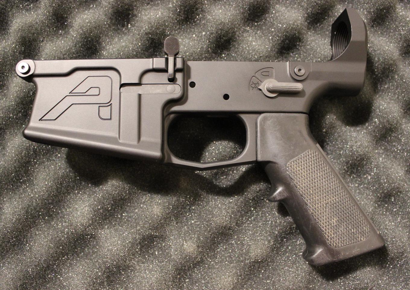

Lower assembled with the parts kit, plus an old A2 grip just as a place-holder. I left out the buffer retainer & spring, as I intend to skip the traditional buffer & spring and use a captured buffer spring assembly, which doesn't require the retainer. Easier take-down and one less part to break.
I have to say, I love how nicely Aero's pivot & takedown pins fit; there is virtually no discernible movement when the pins are fully in place. The Aero lower does incorporate a tensioning screw to take out slop between the lower & upper, but if the upper is as precision-made as the lower appears to be, there probably won't be much play to begin with. The use of a threaded pin instead of a roll pin for the mag catch is a nice touch as well.
The hole for the takedown pin's spring & detent is also threaded for a set screw, but for some reason neither the lower nor the parts kit include that. The pistol grip is holding the spring in for now, just like it does the safety selector spring, but two springs is a bit much to try to keep lined up when installing or removing the grip. I plan on swinging by a fastener store or two while I'm out tomorrow to grab some set screws.

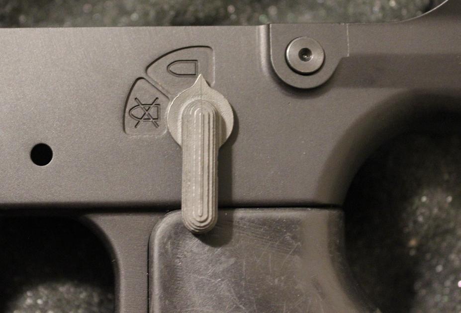

However, I don't think I'm really feeling the safety selector that came in the parts kit. Kinda big, pokes my thumb in the firing position with the A2 grip, and it doesn't move all that smoothly. I'll probably swap it out down the road for something with a shorter throw and/or a smaller lever. Luckily, the Aero lower's selector markings are cleverly laid-out so that they will line up with 90- and 45-degree safety lever throws (and anything in-between).
No rush on that though, this selector gets the job done, and it's paid for. Before I pick out & buy a fancy safety, I'll at least want the grip, stock, and trigger in place, though I'll likely wait until the gun is complete enough to fire.
