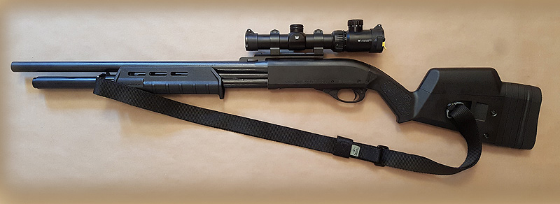

I am running one on one of my 870Ps with Magpul furniture:
