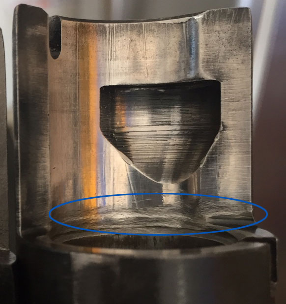

Here's the polish job I did on the factory barrel and bolt. Still had it locking up when hot. So I took the aftermarket barrel hunting yesterday and it never happened ImageImage

Re: Lockup/jam when hot
It looks like you need to polish this area:
Yeah, I was thinking the same thing. The area just outside your chamber looks really scratched/chewed-up for some reason.

Vitaly wrote:It looks like you need to polish this area:
Wouldn't that area show my symptoms regardless if it was shot #1 or shot #100? As in why would that area be worse when the chamber is hot vs no problems at all when fresh out of the safe?
Hard extraction is usually caused by nicks, burrs, flaring, or rough spots in the barrel extension and/or chamber, and that spot looks really rough. Either that or bad ammo, but I'm assuming you tried more than one brand of shells before you started polishing things.
