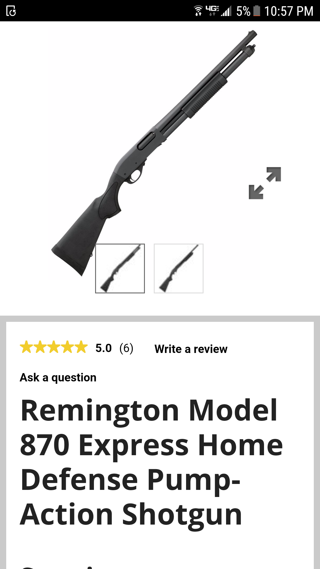

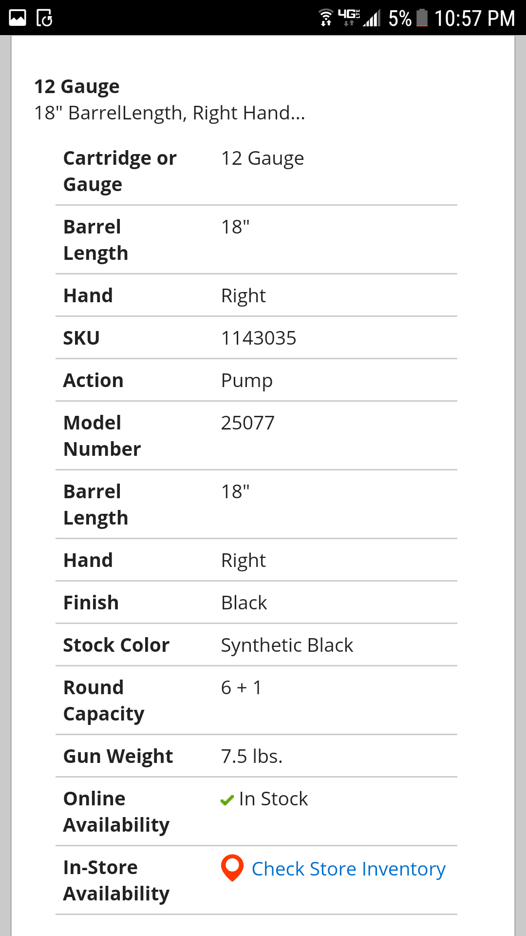

First time posting pics so I hope it worked.

Yeah, that's the one. It's really a nice choice for a dedicated home defense shotgun, since the nonstandard single-piece magazine streamlines the design and makes the gun easier to maintain than an 870 with a standard-length mag tube and a separate magazine extension. Unfortunately, as you found out, the problem is that the people selling the guns often don't know what they're talking about.
I would definitely try to take it back and exchange it for a standard 870 if you want a multi-role gun. The blame is really on them for telling you this has the versatility of a standard 870, when it's actually a non-standard dedicated fighting model. If they still try to say that it has the normal 870 barrel compatibility, tell them to try swapping the barrel from one of their hunting 870s onto the long-mag receiver.
A standard 12ga 870 would have the barrel guide ring directly in front of the fore-end, rather than out near the end of the barrel. It's alright if it has a magazine extension, just make sure that the base magazine tube is a standard 4-rounder.
