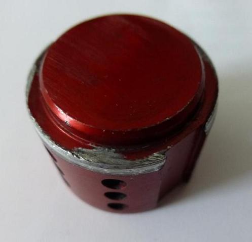

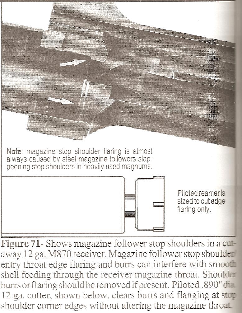

I've never really liked metal magazine followers. Yes, plastic followers will probably wear out faster than steel ones (not sure softer aluminum will outlive a good plastic part, though), but here's the thing: with plastic, the follower wears out. With steel, the gun wears out. Follower stop peening was a known issue back when steel followers were used in 870s, and fixing it took gunsmith work using very specialized reaming equipment.
870 follower stop shoulder damage_repair.JPG (193.8 KiB) Viewed 3887 times
As for aluminum followers, they're softer, and often made from less-costly alloys that aren't all that strong, so they can get pretty buggered up with heavy use.
Peened Brownell's Follower_SJ.JPG (16.36 KiB) Viewed 3887 times
