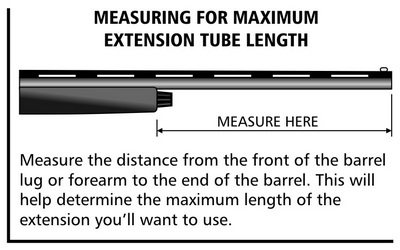

I believe to make it flush with the end of the barrel I need the +5 Tube. I've measured like the picture shows and
get 16". The only thing that is confusing me is the extension tube for the +5 measures 11.5" which wont be flush.
What am I missing? :?:
Re: 870 Nordic Extension Tube
Not sure what's confusing you. It simply sounds like the +5 tube isn't long enough to reach the muzzle. 11.5" sounds about right for an extra 5 shells.
