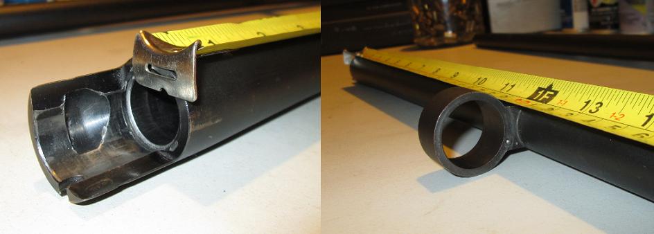

The legal definition of shotgun barrel length is the distance from the closed breechface to the muzzle (or the forward end of any permanently-attached muzzle device). Shooters and gun manufacturers define it pretty much the same way, though sometimes fixed muzzle devices are ignored, or removable ones (like extended choke tubes) are included. For plain barrels though, it's pretty straightforward. Close the action (unloaded, of course), insert a dowel or rod, mark, remove, and measure. A sufficiently-thin tape measure or ruler works, too. You can also measure the barrel by taking it off the gun, and running a tape measure from the back of the chamber to the muzzle:
